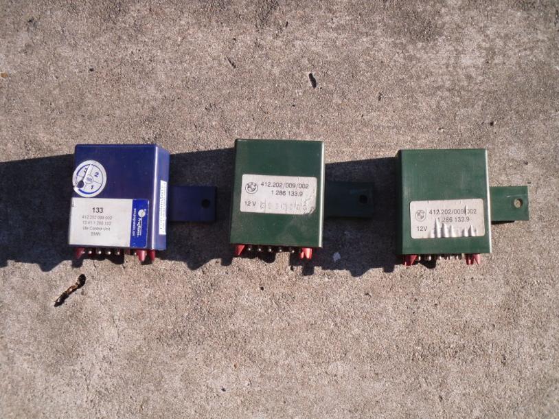

      I posted this in another thread, the only time I had a high idle problem, it was this:
      Regarding the high idle, since you have an eta car, look above where your glove box drops down. There's your normal DME computer then an additional green idle control module (ICM). If this is unplugged or half plugged in, your car will idle very very high, ask me how I know.
