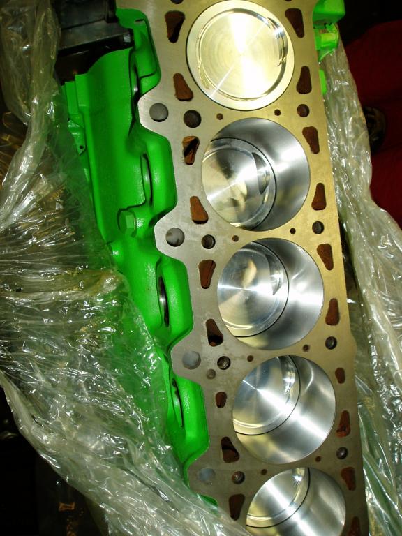

    m20b25 S-52 crank stroker
    On the above should or could the pistons sit above the top of the block?
    I'm using an s-52 crank and con rods with CP-vac custom pistons and the pistons sit a hair above the top of the block, is that normal. Any input would be appreciated.
    Thanks for your in-put
    Dwight

              ,4 extrusion if anybody cares about factory spec.

                Pistons
                86.368mm OEM
                • Sirotto
                  • 317
                  Originally posted by dwight
                  86.368mm OEM
                  Extrusion homie, the height above the deck or into the headgasket and head.
                  "Socialism is a philosophy of failure, the creed of ignorance, and the gospel of envy, its inherent virtue is the equal sharing of misery." - Winston Churchill
                  "People sleep peacefully in their beds at night only because rough men stand ready to do violence on their behalf" -George Orwell
                  • dwight
                    • Dec 2012
                    • 550
                    Piston height
                    Above the deck..about.025 I was told to use a MSL metal gasket and ARP studs.
                    • dwight
                      • Dec 2012
                      • 550
                      Piston height
                      • E30-325iS
                        • Sep 2011
                        • 191
                        Looks like you have a 91mm stroke crank and your pistons were designed for an 89.6mm crank.
                        • dwight
                          • Dec 2012
                          • 550
                          Crank
                          • dwight
                            • Dec 2012
                            • 550
                            Crank
                            The crank was an s-52 do they make a 91mm?
                            • digger
                              • Nov 2005
                              • 6194
                              it is not unusual to have pistons sitting proud of the top of the block on those style if it sits flush the CR might be relatively low?, any competent machine shop/engine builder will know what to do to get it to work but probably how it supposed to be.
