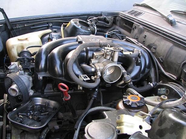

    I've begun the 2.7i stroking project on my m20, here are a couple of pics of the first day's progress:
    Here is a pic of the intake side, with AFM and filter out, along with the timing belt. A MAF is going in instead soon! (when the SMT-7 arrives)
    Here's the valvetrain/exhaust side. Notice the performance (blue) springs, and the Alpina long-tube headers.

    How do you plan to go about this? 2.7 bottom end with 'i' spec head and related bits?

      I already have a 2.5i everything... I plan to stick in a 2.7e crankshaft and rods, and then shaving the head/block to match. I already have higher-compression pistons, so that should keep the shaving down to a minimum. I also plan to install an adjustable cam gear to take full advantage of my 304 cam, and an adjustable FPR (from bavauto), and an SMT-7/MAF combo to top it all off.

        whered you get blue springs... are you sure theyre "performance"

          why didnt you use i rods and not shave it all/much?
            I took them out of a junked Hartge engine. I was still skeptical though, so I put one of my stock springs and put pressure on it, and did the same with the funky blue one. Sure enough, the blue spring was stiffer. That's the only test I could think of to make sure in a third-world country like this...

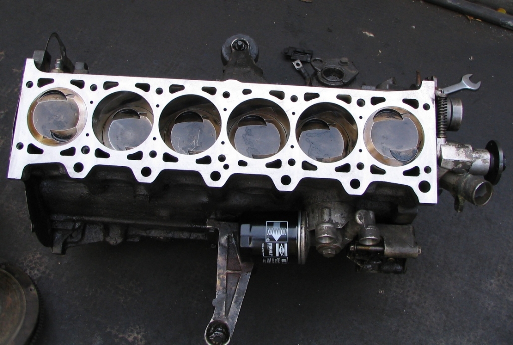

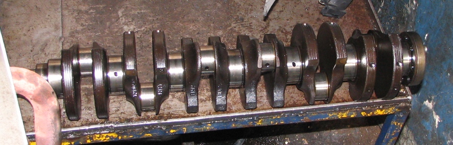

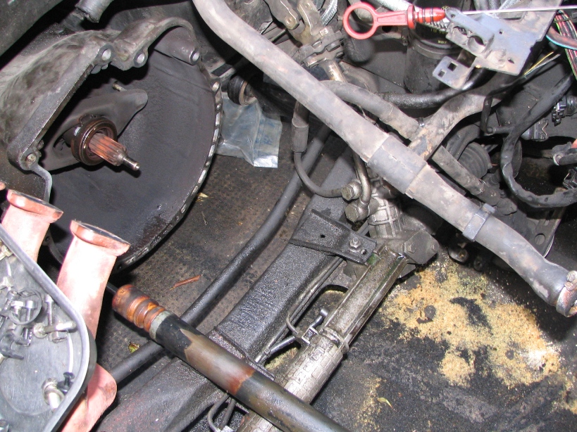

                    Day 2
                    Well, things went along much faster than planned, and quite a bit of the tough stuff is done. Pics:
                    Engine bay is now empty, I'll be replacing engine mounts and clutch bearing thingy while it's accessible.
                    Here's my old crankshaft, already out!
                    ...and here's my block with the 2.7 crankshaft and rods. Note the high-compression pistons that are domed with pockets for the valves JUST IN CASE the timing belt decides to break loose. Looks like the stroke will be all up and running by Tuesday at this rate.

                            Man that went together quick. Did you already have the block machined?
                            I am planning on doing the same build up shortly so I want to know how you make out. Did you get all new rod and main bearings (assuming so). Those pistons look like they are poking out pretty far, did you clearance it with the head to be safe? What is the expected CR?

                              I got a used crank and new rods/pins. the pistons do clear, but make like 10.9 CR (wild I know) I am expecting pinging, and that's the other reason I'm gonna use the SMT-7; ignition timing.
