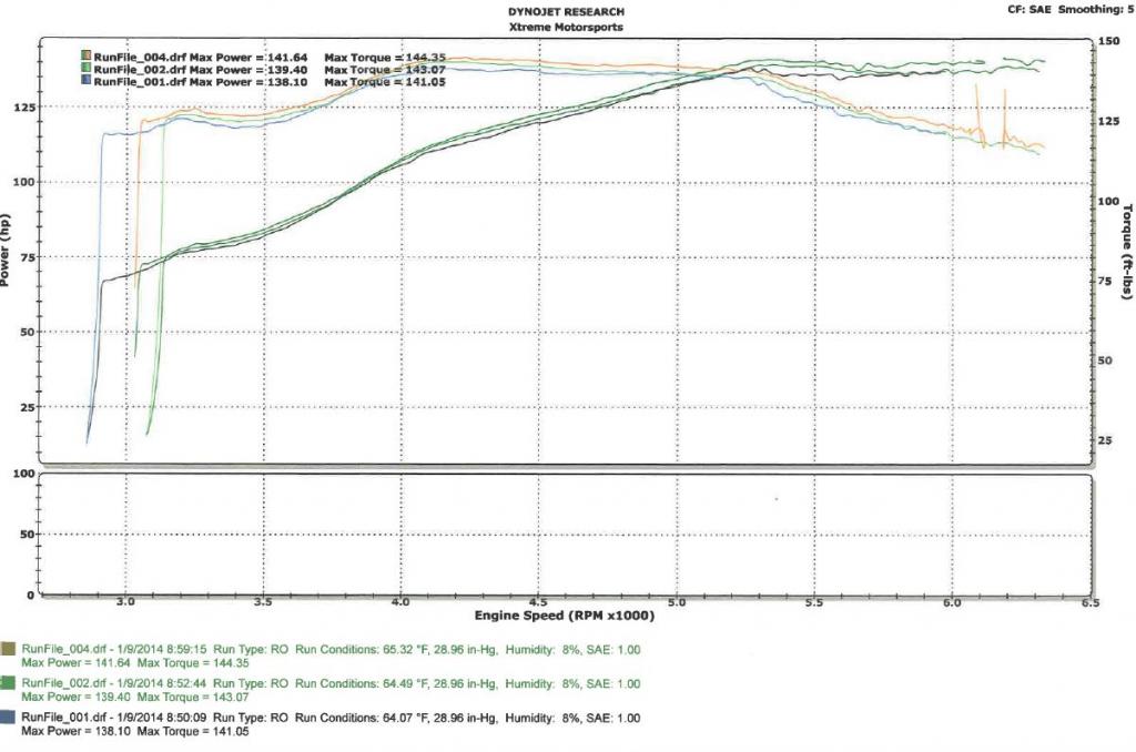

    Just got it dynoed and it's lower than expected (140whp). Unfortunately they didn't monitor afr. So I'm trying to reverse engineer what has been done to the car to get it running well.
    PO mods:
    Mark D chip. 93 octane
    M30 AFM
    Big Bore Throttle body
    19lb injectors
    Adjustable fuel pressure regulator
    Super Sprint Exhaust (catless)
    Looks like new wires and rotor
    I put in new plugs. Smoke tested, no vacuum leaks. Emailed Mark Dsylva but no answer yet. One thing I noticed during the dyno at redline I'd get a puff of white smoke. So I think I need to figure out if I'm rich or lean but could that alone bring my power way down? I've seen cars with similar mods putting down 160 or more to the wheels.
    Dyno.pdf

    The m30 afm and the markD chip may not be playing well. The signal from the afm will cause adjustment to the mixxture and it maybe drowning it. Especially if the chip wasnt tuned for the 19s either.
    • digger
      • Nov 2005
      • 6207
      go to a dyno and get AFR. until then dont guess.
      i would not expect 160 with those mods.

          You must have the AFR plot to find ot what is going on. The puff of white smoke is worrisome. I'd say not to drive the car until you have the dyno/AFR data.
          My Spec E30, with no mods other than the spec exhaust, made 161/159 on a DynoJet on a 100F day. It would probably make a few more in cooler weather.

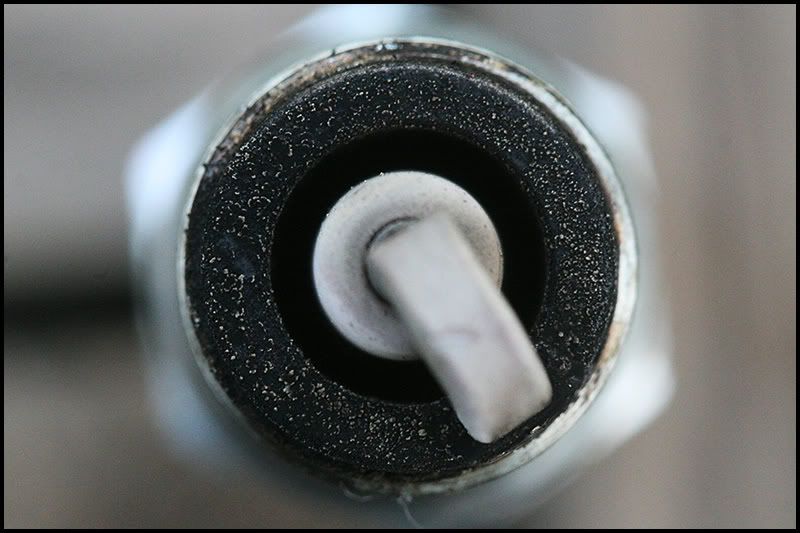

            AFRs from 11:1 - 13:1 won't make a huge difference in power over the entire curve, with that said, if you're richer than 11.0 you'd probably know it by smell and black smoke. If you don't have some soot build up on the exhaust that's another indication that you're probably not running rich.
            I'm going to assume that you're running lean as hell. How do the plugs look? That's your first indication. Also check for freckles of metal on the plugs--if that's the case you're detonating and you could even destroy your motor if you continue to do moderate or hard pulls.
            edit: Here's a photo I pulled from some domestic forum... This is aluminum on the plugs.

              Um, that's exactly what I'd expect since I've dynoed my car with pretty much the same mods with pretty much the same results... 142.7rwhp, 143.1 rwtq to be precise.
              jlevie's engine is a fortunate outlier. I wouldn't expect that from a 25 year old car with some bolt-ons necessarily. Alex S's dyno plots barely make more than that with a lot more $$$ thrown at engine mods than you.

                        btw Jaxx, no freckles of metal on the plugs but they are slightly white so I'm probably running a little lean. I will be headed back to the dyno shop soon to get afr, trying to work a discount since they didn't run it last time when they should have.

                          I can almost guarantee your AFRs are way off on the top end, the roughness of the dyno trace and it's odd flat shape tell me that.
                          There is something holding back available power in your setup, diggers #'s are probably right on.
                          I was quoted above with my 136 whp , after that dyno run i found a MASSIVE exhaust restriction in my aftermarket downpipes which i have since repaired. It pulls noticeably harder on the top end now. That was with a stock chip too.
