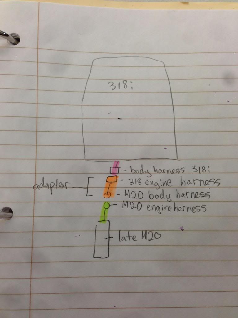

                        Hey guys have all the C101s and such now and just need to find the time to do the swap. It's cold as shit up here and I'm going to get the M10 running first, meaning I won't be making an adapter any time soon. To keep both harnesses intact - 318 body and 325 engine - I decided to make a short adapter with the opposite sides of the harness. Here's a quick diagram of what I mean:

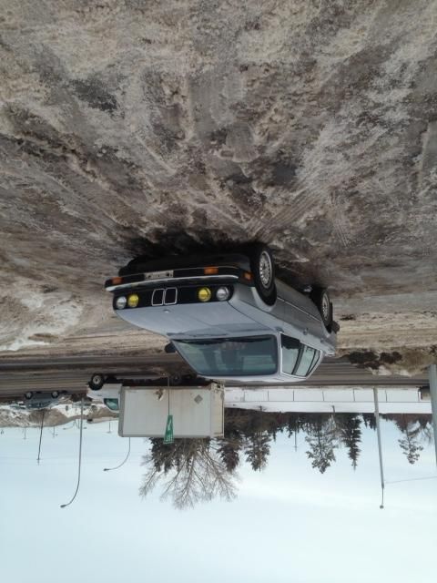

                          By the by, here's the car in question.
                          Her name's Goodrin, 1985 318i with manual everything. Best $650 I ever spent! She idles at 250 rpm currently and one of the POs backed into something hard so the rear is a little mangled. Plans are to get a nice interior in it, fix her up and then M20 goodness to follow!
