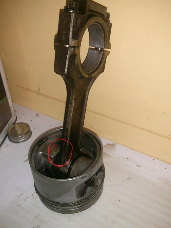

    If anyone has a loose piston laying around, I need to know the distance from the flat spot in the picture to the wrist pin, and it has to be a short skirt piston.

    Can you narrow "flat spot" down ?
    Which part of the piston?

ID:	7165722Sure. Here's a pic of the area I'm talking about.

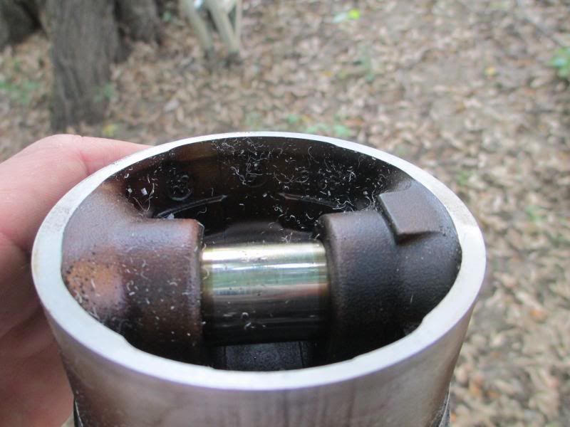

                  Yeah, the early i pistons have a weird raised spot that's the issue. I think some short skirt i pistons are all I need and it will clear with no problem.

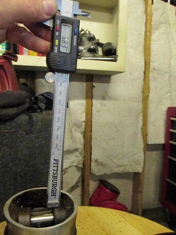

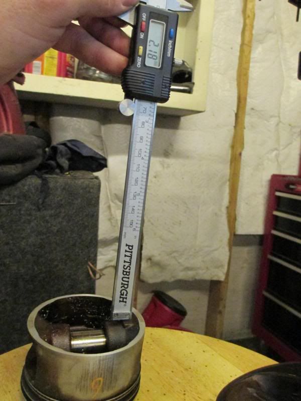

                      5mm is probably right. Here's my measurements of an eta piston and an early i piston with the skirt shaved. There's a raised spot on the early piston that the late piston doesn't have, plus it looks like it's a bit thicker in general to begin with. So including the raised spot, it's they're about 8mm from the wrist pin and barely scrape. 5mm should clear just fine.
