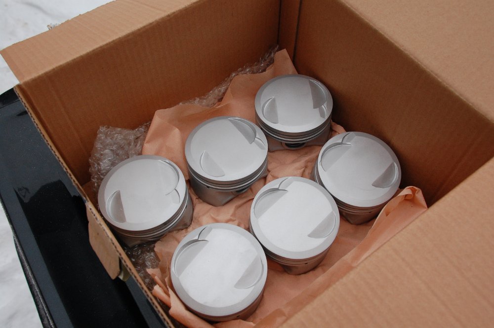

                    You can make the M54 pistons work but it will likely be cheaper just to order a custom set of pistons rather than paying someone to machine M54 pistons to match the combustion chamber of the 885 head and they'll end up looking like this...

                      As soon as someone can show me a case of using this setup and it not working or getting to be $$$ I'll stop it. I know the M54 pistons are not optimal in stock form but if they work with a stick or slightly thicker HG then I count it as a success. The 2.7i stroker is not perfect but runs on the principle of cheap yet effective and worth while. I am not doing this to get a the most power I can, I am doing it to justify not doing a turbo or swap. If it fails I can shave the pistons myself but would not consider a successful budget stroker.
