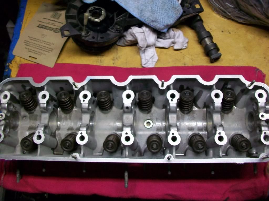

                  Also noticed that seta head has 2 oil passages on exhaust side and 325i only has 1
                  • zesinlijn
                    • Aug 2014
                    • 37
                    here are the 2 heads side by side. left 325i right S eta

                      The 2 passages on one journal are how oil crosses the head to feed the other rocker shaft.
                      The 885 cam had a different- looking (not grooved?) center bearing, I seem to remember.
                      But it's been a while.
                      As to oil flow through the tube, if you can't find anything plugged, make sure the
                      rocker shaft is on there correctly. If oil's not flowing through the shaft,
                      the cam won't oil, and that sprayer bar won't work either.
                      That said, the 'sprayer' bar is more of a 'dripper' bar at idle with cold oil.
                      I suspect at full, hot pressure more moves around, but it's not a spectacular
                      amount of oil...
                      hth
                      t

                        Ok. so the fact that s eta head as 2 journals with 2 passages isnt a problem? means that oil now has 2 holes to go from one rockershaft to the other? 325i head only has one.. i want to keep the s eta head because it has been milled and is much cleaner.
                        i really hope that drilling those 3 extra holes solves my oil feeding problem to the tube..
                        • TobyB
                          • Oct 2011
                          • 5263
                          As long as the cam has a groove in the 2 bearing surfaces to let oil cross it, it should be fine.
                          If it only has the center bearing surface grooved, you should have the center one drilled to the
                          other side to let 'full' oil pressure get across.
                          All that really shouldn't affect the sprayer bar, though- it's fed from the front and rear
                          journals, and THAT should be getting pressure no matter what.
                          I wonder- take a look at all your cams and see what the differences in them are.
                          That might do it, too.
                          hth
                          t
