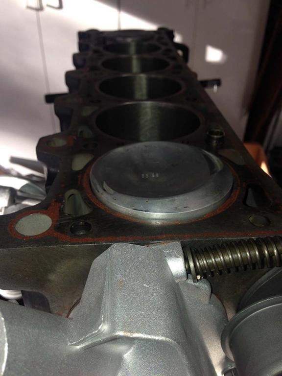

    My first rebuild, bought the car and it came with a spare motor. Ended up using the crank from the spare because a bearing had spun in the original. I didn't think to check the crank throw on the new one because i thought it was from an I engine as well.
    I went to put the head on and it does not fit, my only explanation is that it is an "e" crank with the longer throw. The pistons are a little over 4mm above the block at TDC...
    Advice?

    Did you use the original I rods with the new crank, or the rods from the other motor the crank came from?
    Sounds like you have the 2.7 l eta crank and the 135mm I rods and pistons.

      You didn't think to double check the parts you were installing were correct so now you have to pull the crank.
      Or they decked the block too much.

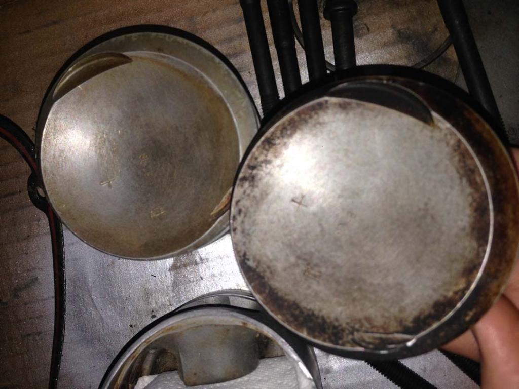

          Do you have a pic of the pistons that were attached to that spare motor crank?
          We're they flat?

            nope not flat, here is a pic

                Those pictures aren't very helpful. It could have been a super ETA engine which would explain a lot.

                  and how would i find out if thats the case? What pictures would be helpful?
                  Edit: I think your right its a super eta, was researching up on this and it does have single valve springs, sounds like the answer.
                  From what i've read i can just get a set of shorter eta rods and make this set up work? Is this the most beneficial way to go?

                    If you do in fact have Super Eta pistons you can use them with an Eta (or Super Eta) crank and rods.
