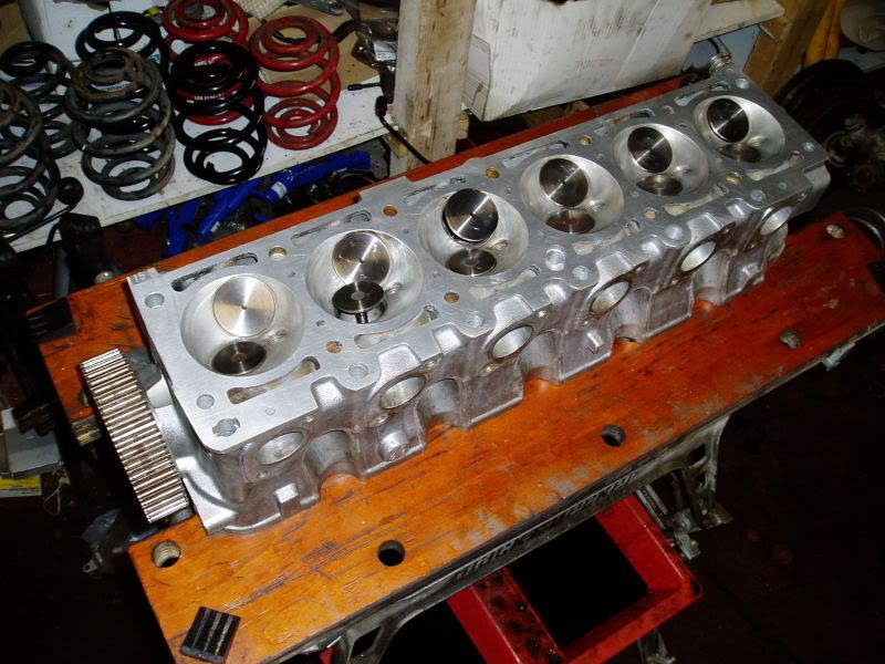

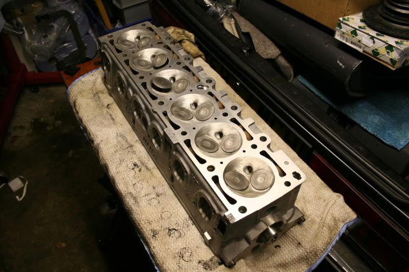

            any pics of what the chamber looks like?
            and is it done on and eta Head or 885

              they convert the 885 to a open hemi style and remove the angled squish band for the most part, these days engine designers and builders take the opposite approach with a smaller closed chamber and plenty of squish for a more efficient design. even the modern hemi strickly aren't real hemi's anymore
              the inlet flow is basically the same as stock but the exhaust flows better. the exhaust port is gasket matched
              any competent head porter should be able to do a far superior job IMO

                ahhh i see so they took out the hump part... but its not worth it you think? im trying to open up the head on my 2.8 build m52 crank stock I pistons E rods, but i dont want to go crazy, doing a bunch of porting and such so i was thinking a reground bimmerheads cam, and the alpina treatment.

                  i wouldn't do the alpina treatment, firstly it lowers compression ratio, increases surface area, reduces the squish band which is there in the first place to help reduce tendency to knock and provides mixture to improve combustion efficiency.

                            Entertainingly, this follows what bmw motorsport/Alpina did on the M30's and M10's. It also makes them much more susceptible to cracking between the valve seats. You won't find a true early Alpina M30 that hasn't had at least a couple cracks repaired. I took pictures of one hemi'd head that had a repaired crack in each of the 6 chambers.
