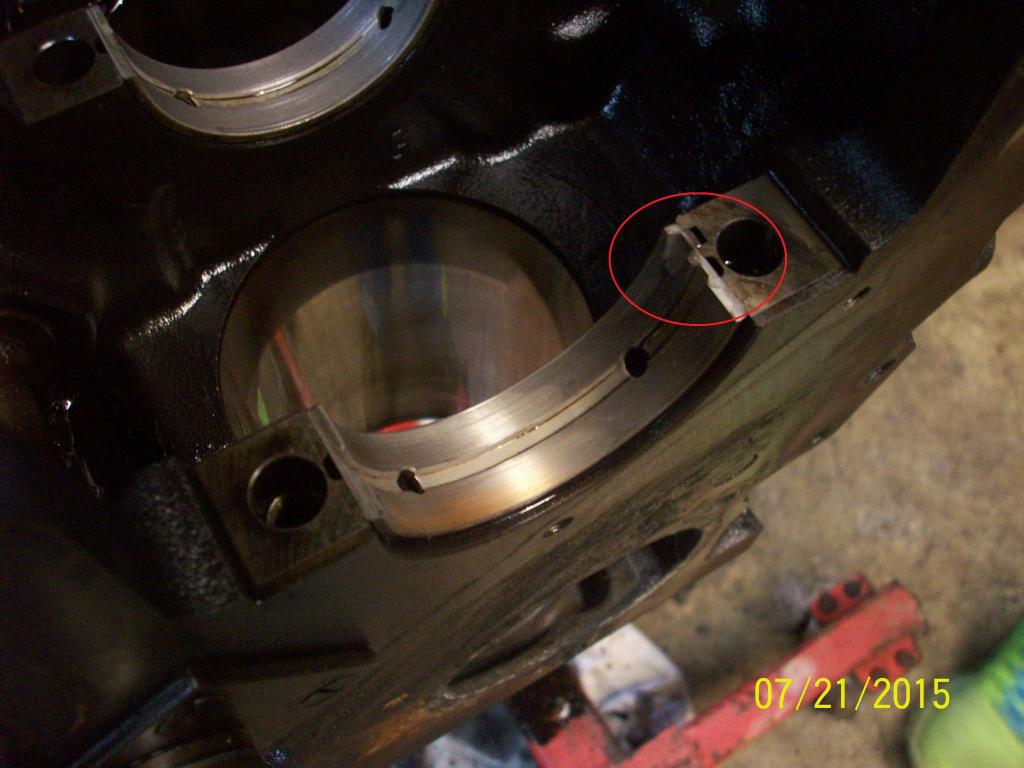

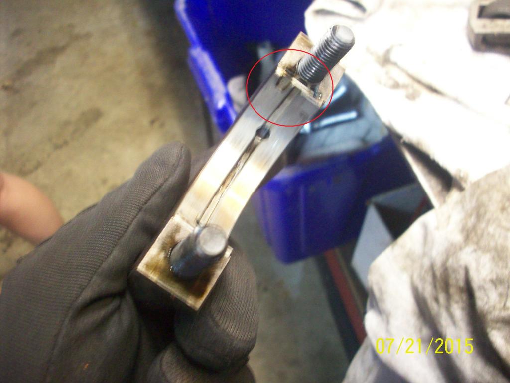

          I just did this with an "e" model - but I think it is the same.
          When you pull the main cap off- look at the slots in the bearings.
          I believe the must match up from the cap bearing to the other journal bearing.
          My slots on the e engine (with engine upside down and I was standing at the front of the engine (intermediate shaft to my left side facing me -see pic)) - the slots are situated on the right side from this point of view.

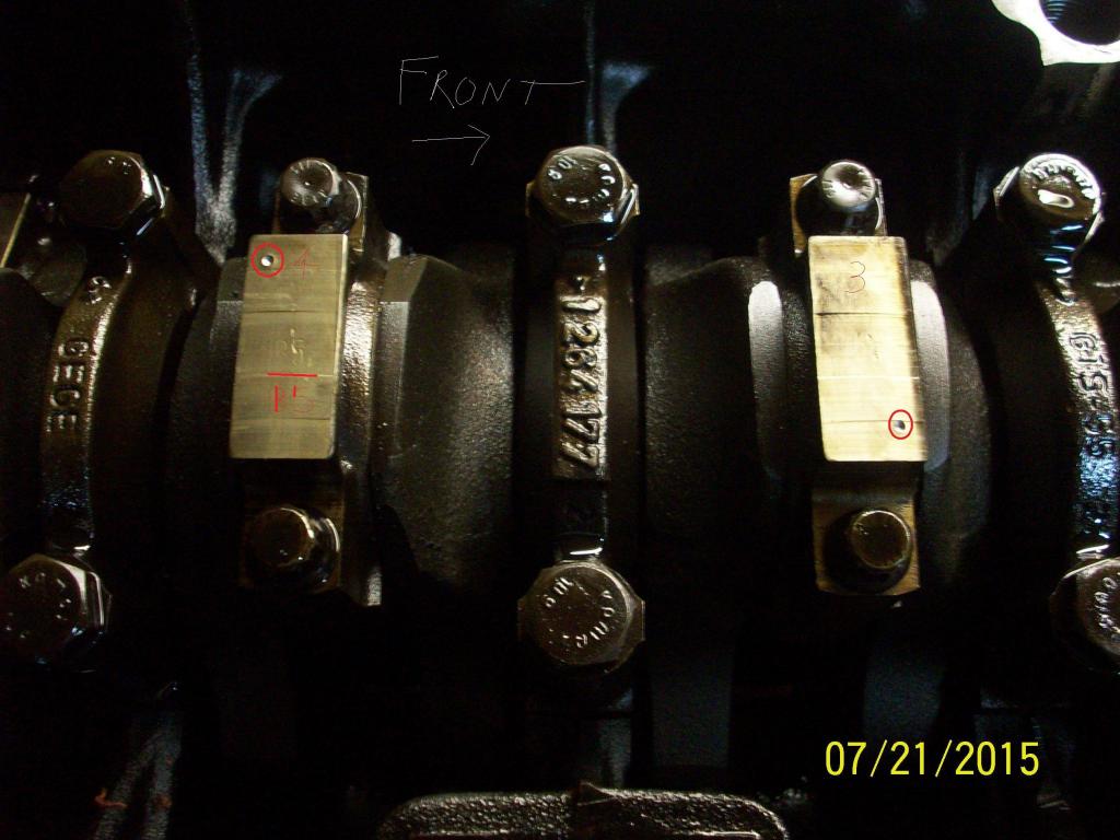

            Also - main caps are numbered and start with number 1 from the front (same position that I explained before)

                    Yeah, 95 said it- the indented notches for the bearing caps are both on the same sides.

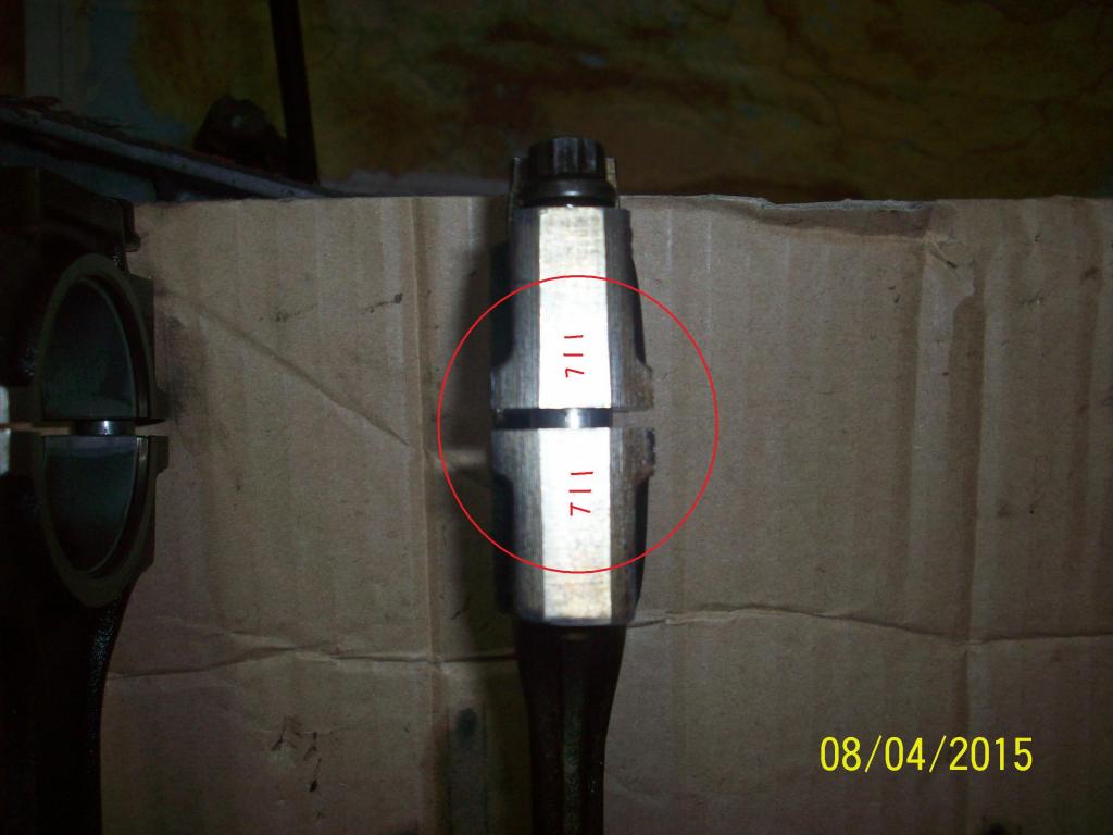

                      The rods and caps will have random numbers on the sides near the rod/cap spit, the rods and cap numbers will match.

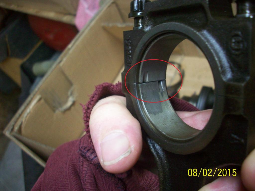

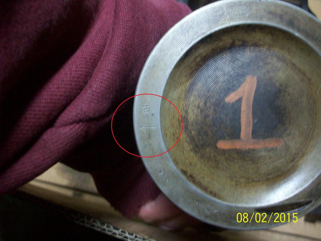

                        First - just double check the arrows on the pistons - to make sure they are all pointing in the proper way (to the front or radiator end). See pic #1 these are e pistons - but the i pistons should also have it.
                        From the bottom looking at it from the orientation I stated earlier - you will have a couple of slots in the bearings - plural (top and bottom) -(they are offset) and for me were on the right side of the piston cap when installing . See pic #2
                        the stamping does not necessarily tell you the orientation ( I have one piston rod cap that is backwards from the rest) - be aware that each cap is matched with each piston rod - if these are not matched correctly you could have some serious issues (because they were balanced and matched in assembly).
                        for my last pic - I marked each cap to know the orientation and the sequence..
                            True.. Have a pic of that too somewhere..
                            The numbers are stamped on one side - very faint - same number top and bottom. The other 5 pistons were all different random numbers..
