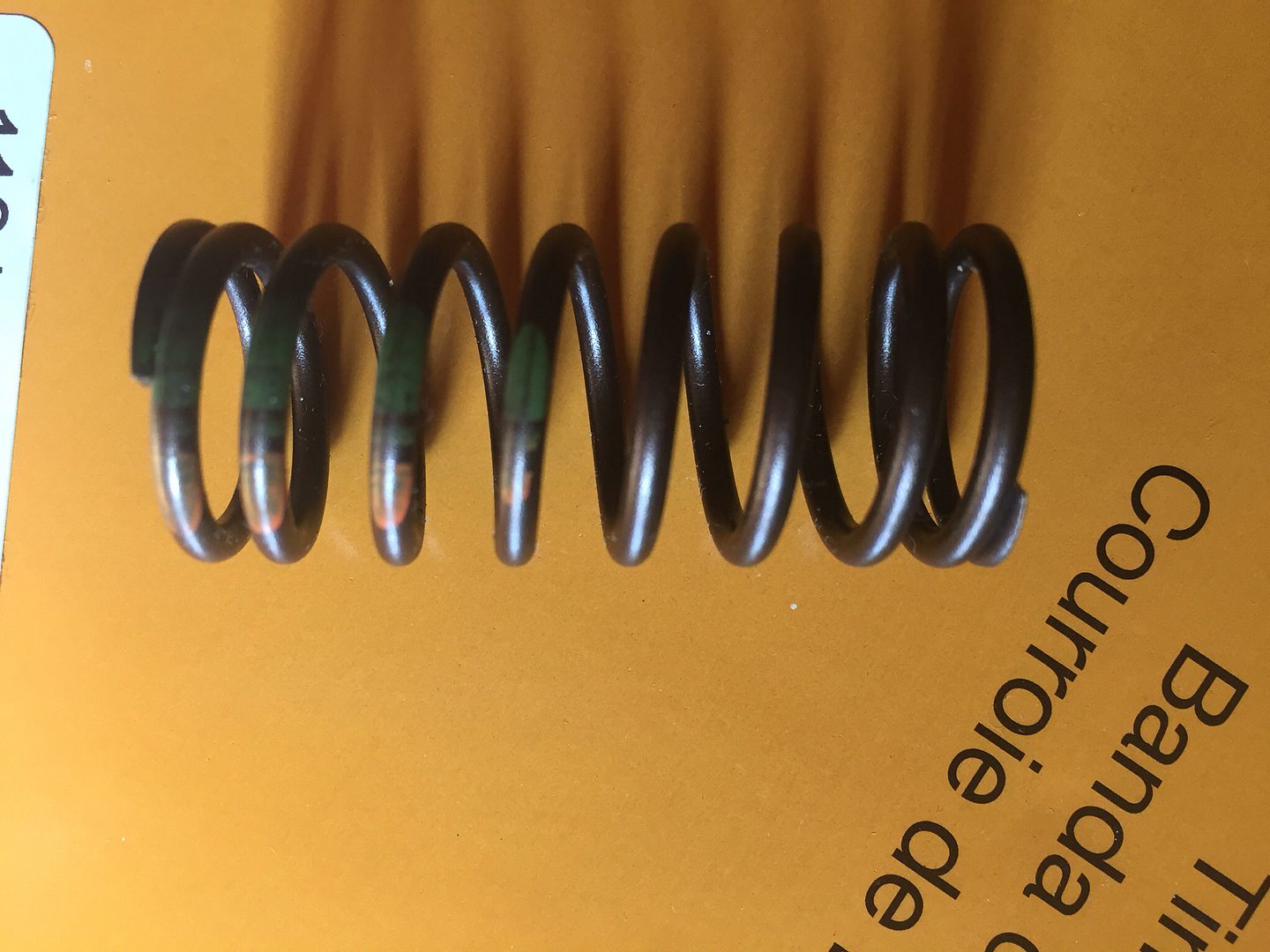

                          • jeffnhiscars
                            • Jun 2011
                            • 6011
                            I received a dozen of these today. They were shipped loose so I can't confirm much although the paint markings do seem authentic :)
                            Dimensions seem right and they came from eeuroparts.com in CT and were $5.99@
