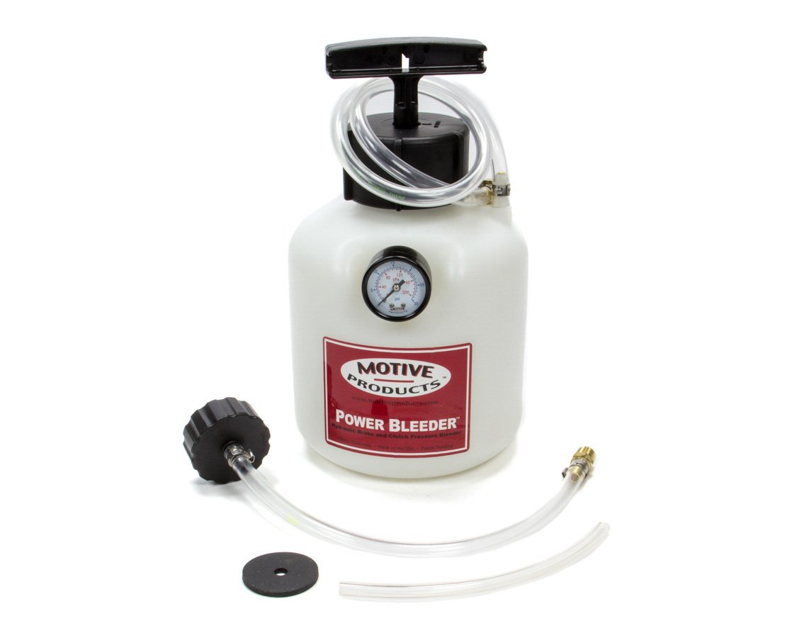

      I have a pretty normal/stock brake setup, but I use the Motive bleeder on my track car. It's fast and easy. Very nice to be able to quickly bleed brakes by yourself.

        I have been putting off doing my SS lines because of bleeding hassles. Thanks for the info, I'll order one of these bleeders.
        Seems like there are several options, is this right?
        https://www.amazon.com/dp/B0002KM5L0...bit_scomp_sav0

          That's the right one for an E30. Motive Products 0100. Confirmed in Amazon reviews. Good tool for $50.

            I used one of those when i replaced my master cylinder. Didn’t even have to bench bleed it. Made it so easy. Just takes a big jug of fluid to work.

                  Onward to the brake bleeding. We're using a motive power bleeder, pushing fluid from the reservoir down to the caliper bleed screw. No need to pump the pedal. Fluid is easily collected at each caliper and reused in the pump.
                  We saved much grief by pressurizing the system with just air before beginning. It was easy to visit each fitting, listen for air leaking and tighten accordingly. No mess. Then the bleeder was filled with fluid and re-pressurized.
                  Bleeder eliminates the whole "open valve, push pedal, close valve" dance. You simply open the bleeder valve and wait until air bubbles are not coming out any more. Bleed from the caliper top screw. This caliper has outer and inner bleed screws. Outer first, then inner.
                  We made the bleeder hose sleeve because the tube kept slipping off the bleeder screw. I can't believe they don't make something that snaps on to the bleeder screw. Need to google this more.
                              Mine is perfect for the BMWs...but after buying the black line accessories to fit my Chevy and Ford, it sucks. The seals would fail at the MC. So ya get it pumped up, walk away to crack the bleeder and poof... an explosion of brake fluid at the reservoir.
                              Starting to rethink mine.

                                We only pressurize to 10 psi. Works fine and no risk of fluid everywhere.
