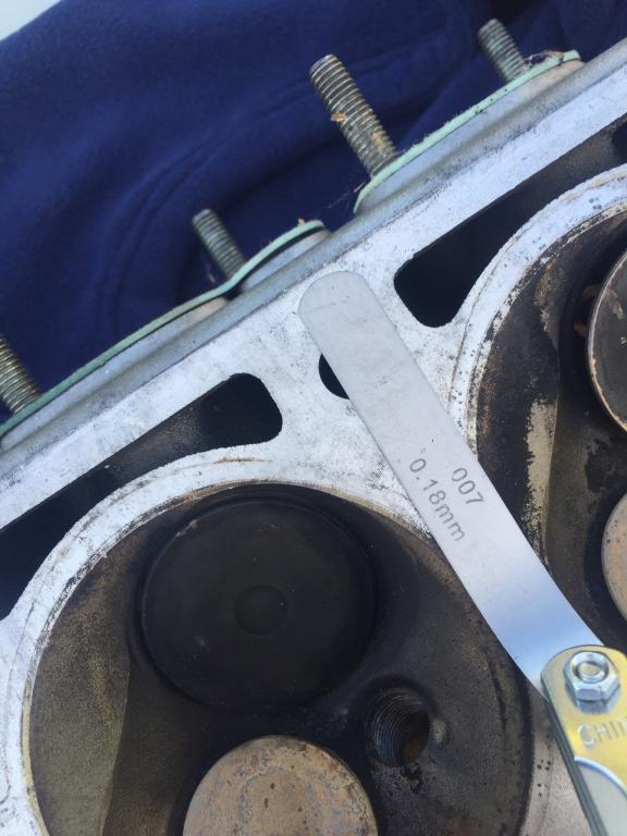

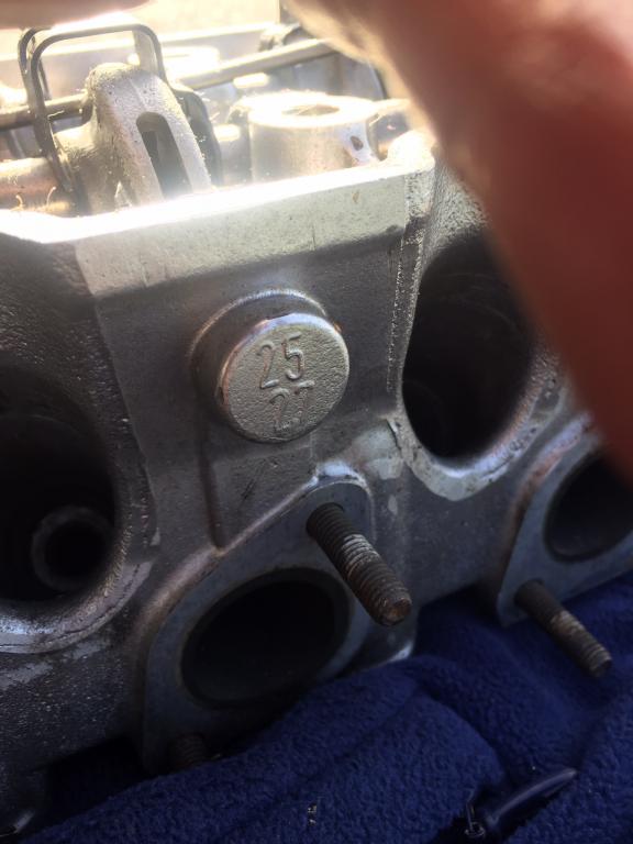

                  everyone told me to get an 885 motor because I can get more power (peer pressured), so I went for it lol. I bought a super eta head (him not knowing it) for 100 bucks with only "120,000 miles". HOWEVER... when I checked it on the spot it was .007 warped in only one spot. But I checked it dirty, tomorrow ill clean it with a razor blade and check it twice. Im no mechanic I doubt it would make a difference if it was dirty or not.
                  but I'm hoping its still serviceable
                  (below is the warped area)

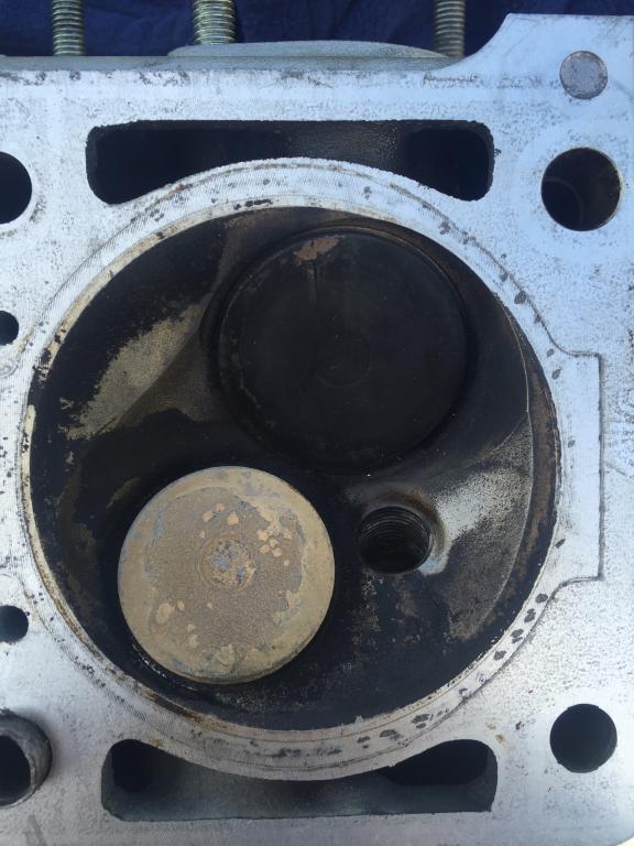

                  DIRTY LEFTOVER HEAD GASKET
