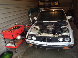

    Hello fellow E30'ers,
    Let me start by saying I've read nearly every post on this, and other, forums over the past month or so that relate to a broken E30 timing belt. There are so many enthusiasts on these boards that serve as a wealth of knowledge, and for that - I'm appreciative. Also, this post is a bit lengthy, but stick with me - I want to be thorough.
    From the beginning:
    - former E30 owner, and was eager to rejoin the community
    - purchased a 1990 325i vert in Jan 2015 (rough interior, minor body imperfections)
    - spent spring/summer collecting various parts (interior, seats, new oil cooler)
    Labor day weekend, I took the car out for a drive after replacing a bent oil cooler, changing oil, changing spark plugs, installing new brackets for 87 IS front valence (and mounting valence), along with a thorough cleaning. It was a great day, with the top down, zipping around some back roads.
    Following day, we were out for another drive and the car died turning into a parking lot not far from home. After a relatively brief diagnosis, it was clear I had a broken timing belt.
    *At this point, hindsight is definitely 20-20 : yes, I realize I should have planned to do the timing belt by this point (8 months owning the car) since the maintenance was not well documented.
    Research begins. Most forum threads indicated head damage is common. I decide to swap the belt and go from there.
    Cleared my Saturday schedule, and performed the following:
    -replaced timing belt (adjusted timing back to marks on cam/head, harmonic balancer/block)

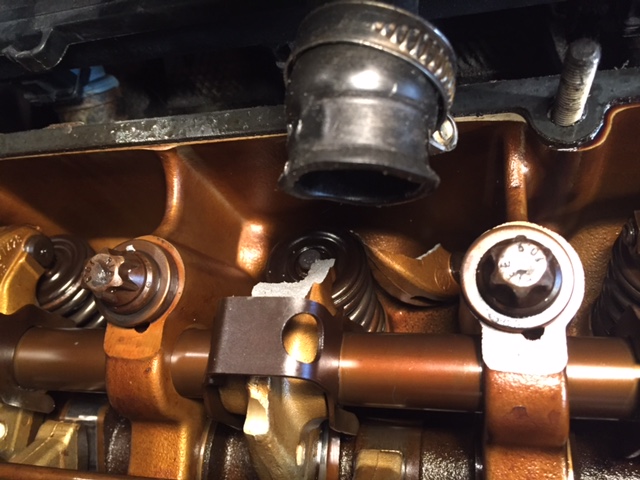

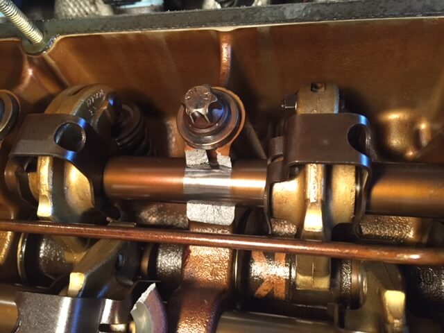

    I pulled the valve cover off, and discover #5 intake valve rocker is broken, as well as section of head where rocker shaft passes through. (Pictures attached). I wasn't surprised to see a broken rocker, but was less than thrilled to discover damage to the head itself.
    With the valve cover off, I turned the crank by hand and watched the camshaft turn all 6 cylinders. I was able to watch intake and exhaust valves open/close for each cylinder, with the exception of intake on #5 since the rocker is broken off.
    I have many questions about replacing the head, which valves/springs to use, and if anyone has feedback on the bimmerheads cam (or others) - but let's come back to that.

    Is your camshaft actually turning on cylinders 2- 6 ?
    I've seen a camshaft snap after the #1 cylinder bearing when a piston/valve collision has occured on that cylinder.
    Either way that head has to come off to assess how much damage has been done - unfortunately it's usually substantial.

      Yes, I should have been more detailed about that. I will update the original post.
      With the valve cover off, I turned the crank by hand and watched the camshaft turn at all 6 cylinders. I was able to watch intake and exhaust valves open/close for each cylinder, with the exception of intake on #5 since the rocker is broken off. I also confirmed spark and fuel at each cylinder (while troubleshooting, prior to discovering the broken rocker/head issues).
      I'm expecting a fair amount of work to be done. But with the cam turning, valves opening/closing on time, spark and fuel (at the assumed correct time), I still think there should be SOME compression or perhaps even an attempt at fire/combustion. Again, this is purely driven by my curiosity - not any expectation that I will be solving a problem by finding compression.
