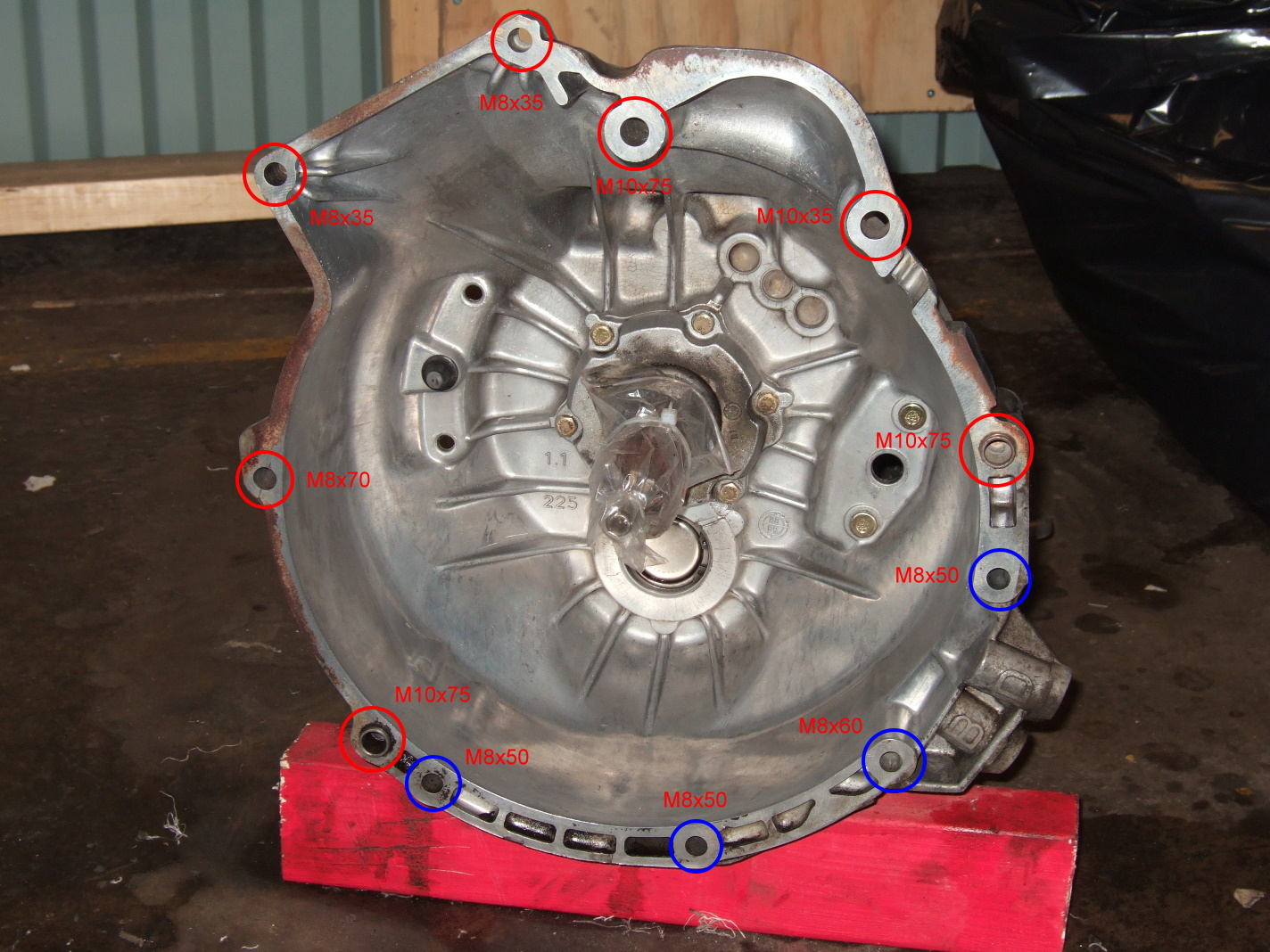

      I'm obviously not familiar with the terminology but when you say dowels you're talking about those little lips the metal shield sits on?
      • Kershaw
        • 11822
        M10x75 is what the dowels will look like. It's those little protrusions to help seat things.

          Damn. Those dowels were not seated in the transmission like that photo. They were seated in the block. Would that make a difference ?
          • Kershaw
            • 11822
            I was just showing what they would look like. I was in a hurry at the time. That's for an m30 I believe.
