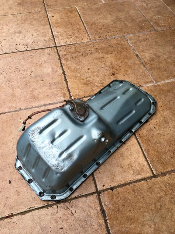

        Update on my position.
        The oil pan i got did not fit. I jacked the engine up as high as i could and the oil pan would not clear the steering rack.
        so either the guy i bought the pan from didn't know what he was selling, or he did.. or i didnt jack the engine up high enough.
        The oil pan gasket for my m20b25 match right up with this CL oil pan bolt pattern. That being said this CL pan has like an extra 3 inches of meat on the back of it where its closest to the steering rack. even if i could drop the sub frame it still looks like it would come into contact once the car was lowered.
        I tried posting a picture earlier but i don't think you can straight off iPhone but this time I included a picture of the oil pan any ideas of what i have?
        • Swanny
          • Mar 2012
          • 2834
          Steel pan out of an e28 i believe.
          Swanny!
          SUCKERS.
          • TobyB
            • Oct 2011
            • 5250
            Yeah, not E30 that I've seen...
            t
            • ethrty
              • Nov 2009
              • 342
              thats an E28 pan. but if you asked for a B27 pan then thats what you got, so really buyer beware. tough break.
