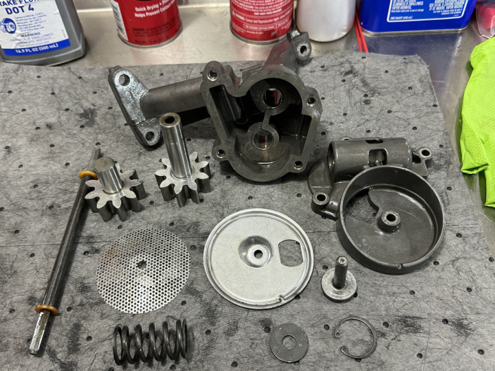

                    • RicardoD
                      • Nov 2023
                      • 7
                      Reviving this thread as this forum as usual is a goldmine of information. I took my oil pump apart and just wanted to document in case anyone runs into this thread again. My plunger looked fine but out of abundance of caution I will replace mine. My ultrasonic cleaner really does the job on parts like this.

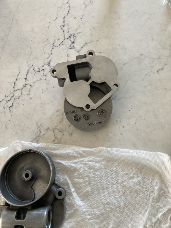

                      • PEZ2
                        • 50
                        Just wanted to add note on resurfacing the lid as part of the pump rebuild.

                              RicardoD How in the world did you get that spring + washer + c-clip back installed? I have been struggling with mine for the past hour and haven't the faintest idea how you would compress the spring enough to get that c-clip back in its home...
