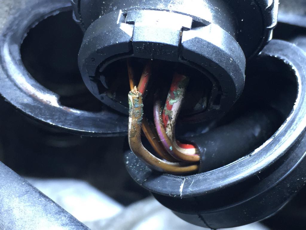

                  Fellow Bimmerheads,
                  First thanks to directing me to check the C191 connector. As I was finishing up using contact cleaner and wiping down the residue inside the male connector boot, two wires just separated from the connector from corrosion which is not visible. I am really fortunate to have this happen now and not on the highway. Most likely this has to been the gremlin hiding the past several year awaiting to cause breakdown that would have stranded me.
                  Most appreciate to you all for directing me to it.
                  Will provide update once I fix the wiring and if this is the culprit, those with this intermittent problem should redo the wiring since the corrosion is hidden from inspection.

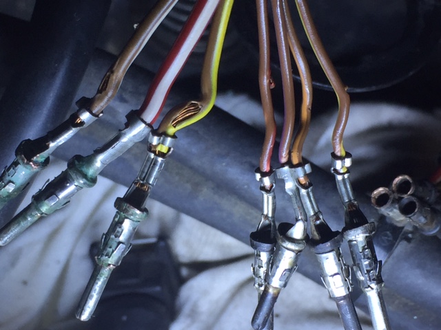

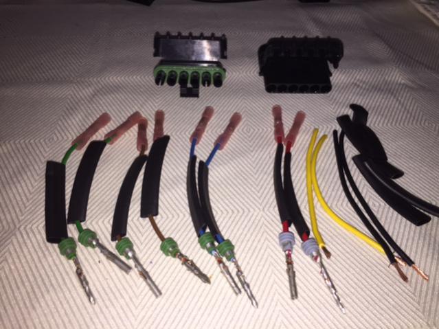

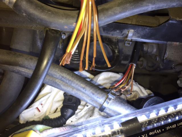

                        Gremlin Update:

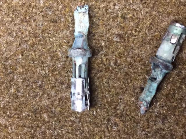

                        Corrosion at the male side of the C191 Connector was severe; three wires were corroded severely and most likely either severed or hanging on by strands. This may explain the early symptoms of cutouts in high temperature areas (100 degrees F).
                        The wires in the care are prepped and ready (I may need to cut off more based on the oxidation on some of the wires-see discoloration on photo); I under ordered the Weather Pack seals. Stupid me , I was only thinking 6 wires, not 6 sets of wires so only have half of the seals; I will need to wait until Tuesday to have my "is" up and running. I ordered my Weather Pack material from Del City in NV; very quick service and you do not have to buy in bulk. Also, being a tool snob, I purchased the 1-step crimper thru Amazon.
                        Next update will be with the connectors and hopefully car running. :D

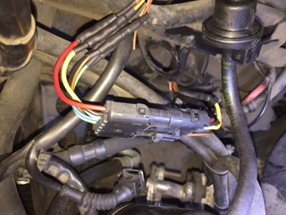

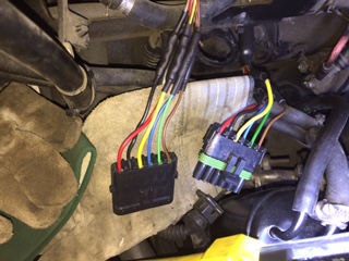

                          Finally completed replacing the C191 connector with a Weather Pack.:razz:
                          As others have mentioned, there are only six connected wires; the seventh is open.
                          Test drive it tomorrow and will provide an update in the future to confirm the exorcism of the gremlin. :devil:
