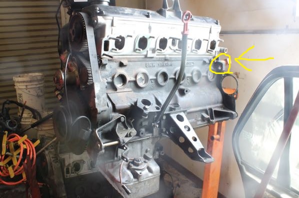

              Thanks for those pics. What did you fasten the rear chain to?
              Dave
              '91 325iX
              • noid
                • 1537
                Attached.

                    What are you guys using to hook that hole? I'm also in this boat. I can pull the old motor around the intake mani but my new motor has a nicely painted mani so I don't want to damage it.
                      I used chains with nuts and washers and put a durable blanket between the rear of the manifold and the chain where they could make contact. Then just took it real slow and easy.
                            Looped the chain through the hole then connected the end of the chain via a quicklink.
