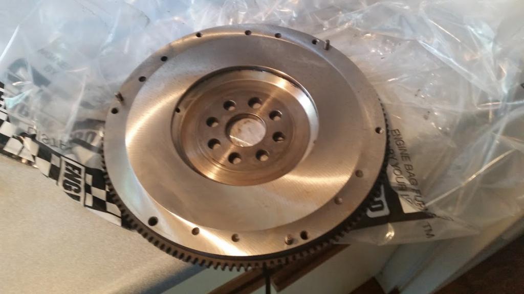

                  Re: the flywheel, I just took a look at your pics and the flywheel looks like an "i" flywheel to my eyes.
                  The eta flywheel looks like something out of an old timey car... But do a little research.

                      This is my "i" flywheel for reference.

                        Hmm.. Definitely looks very similar. I know my flywheel is an 'e' because it does have the metal hump for the CPS. Other than that, they look identical. Once I pull the transmission, I can get them side by side to compare.
                        • spec-al
                          • Nov 2014
                          • 56
                          Interesting! I assumed all the etas had the boat anchor single mass, but maybe the dual mass isn't that far off from the "i" flywheel...
