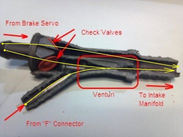

      ive got the other style vacuum system connect direct from booster to post throttle without the other line. dont know what the function of the additional line is. if it a straight Y-piece isnt it just a leak?
        It seems like it is just some kind of bypass and removing didn't change a lot... Also is ICV supposed to be spring loaded? Because my doesn't spring back when closed...
            It's not the straight Y, just like reaoem description says - air pump aka jet pump aka venturi pump. Below is a cross section from e39 but e30 one has a similar idea behind it
