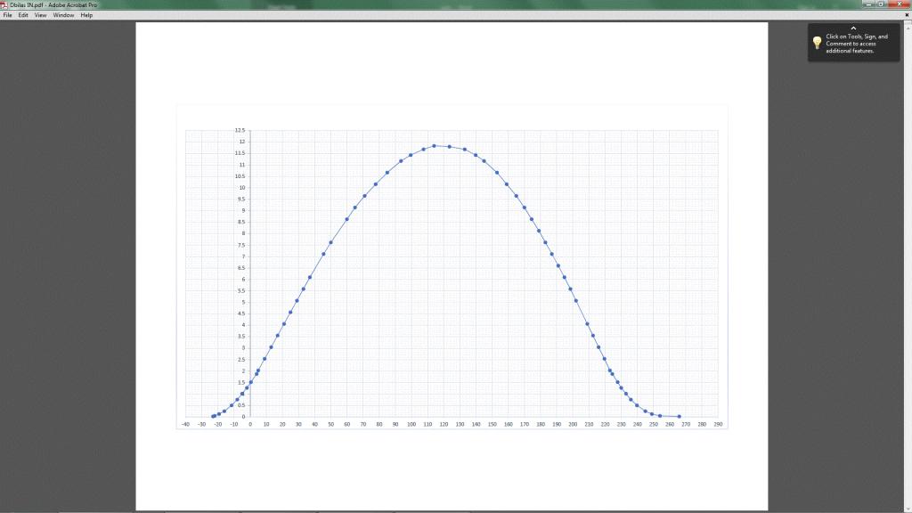

            • zaq123
              • Jul 2016
              • 1559
              didn't have much...only was able to do IN side plot. What do you think? This is with HD rockers.

              • digger
                • Nov 2005
                • 6176
                at 0.5mm open is -12* and close is 240*. so that is 252* duration at 0.5mm. centerline is 114.
                at 1mm open is -5* and close is 233*. so that is 238* duration at 1mm. centerline is 114
                at 5mm open is 28* and close is 202*. so that is 174* duration at 5mm. centerline is 115
                this isnt a big duration cam it is smaller than the 288
                if the exhaust side is the same centerline then something is wrong (the lobe separation is too high), otherwise it could be retarded 6* or so
                i would repeat measurements on exhaust side

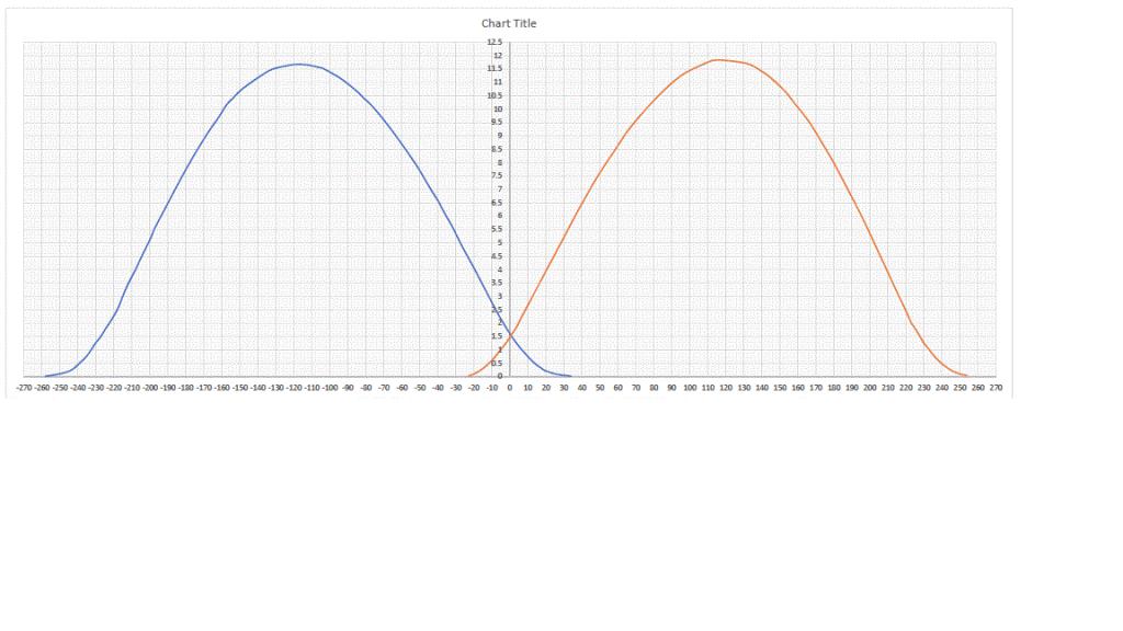

                  • zaq123
                    • Jul 2016
                    • 1559
                    Doesn't look too good, EX center line looks like 112

                      • digger
                        • Nov 2005
                        • 6176
                        for exhaust at 0.5mm open is -240* and close is 15*. so that is 255* duration at 0.5mm. centerline is 112
                        at 1mm open is -233* and close is 7*. so that is 240* duration at 1mm. centerline is 113
                        at 5mm open is -200* and close is -28*. so that is 172* duration at 5mm. centerline is 114
                        yeah lobes are definitely further apart than they should by about 4-6degrees. you could try contacting them, did it have any numbers on the cam, usually they put them on the end. it might be a different cam the numbers are more inline with what id expect with a 284 as the duration at these check points are only a few degrees smaller than a 288
