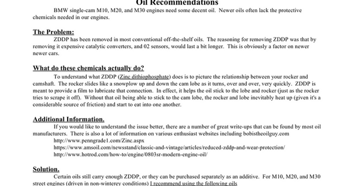

        Oils are very much an integral factor into premature wear issues (and 150k is certainly premature.) I've taken apart/built/maintained dozens of m10,m20, and m30's (and forcedfirebird has done the same, if not more). Here's a little write up...
        ADAMSAutosport@gmail.com Oil Recommendations BMW single-cam M10, M20, and M30 engines need some decent oil. Newer oils often lack the protective chemicals needed in our engines. The Problem: ZDDP has been removed in most conventional off-the-shelf oils. The reasoning for removing ZDDP wa...
        Your other advice is great though.
        OP, in addition to the other advice, be religious about your valve adjustments. If you are getting new rockers (and opt to NOT run HD rockers), then take the extra time to grind down the stress risers (casting ridge and logo imprint) on the eccentric forks.
        BTY, the wear in your photo isn't bad. Just be consistent with your oil changes and valve adjustments.
