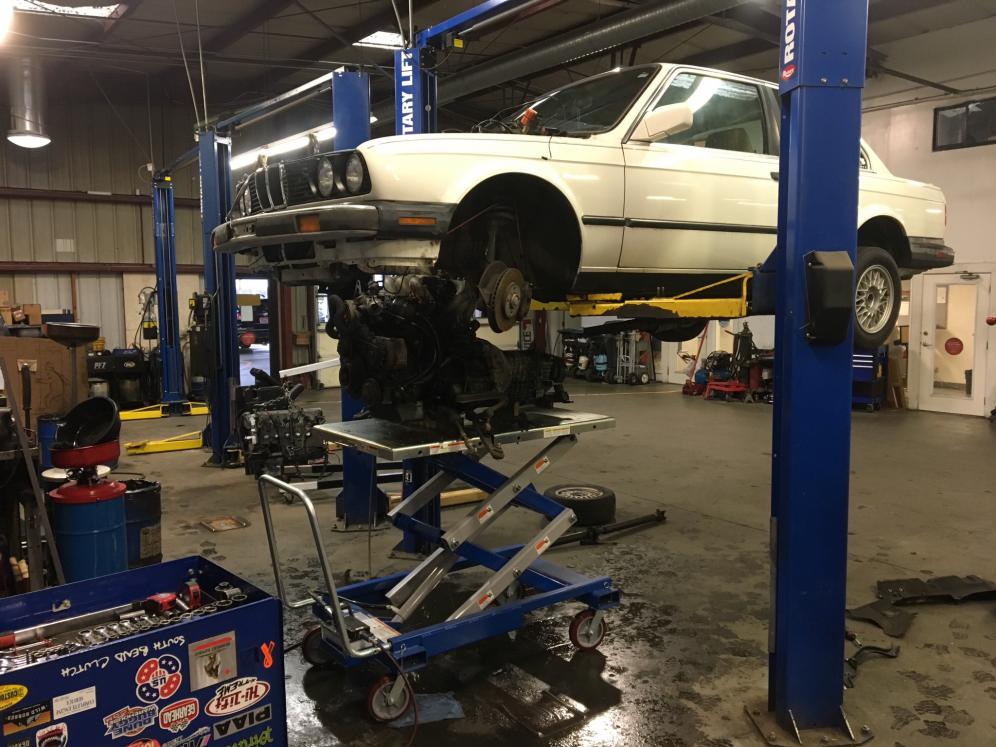

    Not new to e30s just r3vlimited. I have been reading related threads for a few days and not sure I have my answer. I picked up an '87 325is that has a lower end knock, I have an e long block that I want to swap in until I tear down the i engine and decide which direction to go with it based on the damaged found.
    What issues may I have swapping long block for long block? I know all the i stuff has to swap over to the e long block.

        Yeah, long block will be the only swap, ecu and all sensors will remain with car and/or swapped onto 2.7
        I was mostly curious if there may be an issue with the added displacement or cam profile since I'm retaining the 200 head.

            I understand this, it's only a temporary swap. If I find the 885 head off of my i engine to be ok then I will either bolt it onto the e lower and boost it or possibly build a stronger stroker out of the i engine using a 524td crank and aftermarket pistons. I just want to be able to still drive the car while I sort that out.

                          Swap is done, runs good. It’s been years since I had my old ‘87 is but it feels strong for an e engine. Current next step is likely installing the i head off the knocking block since it isn’t hurt.
