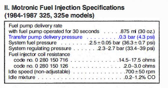

    Hi guys,
    I'm refreshing my fuel system, and looking to source some replacement fuel line for my Lift pump to high-pressure pump.
    The factory stuff is 12mm inside diameter. I've found some Gates Barricade 1/2" Inch Hose, but it's only rated to a working pressure of 35psi.
    Any idea what pressure the lift pump puts out?
    Cheers!
    EDIT:
    Posting the answer here should anyone come across this thread in a search:

    Very low, like 4 psi. It's a high volume, low pressure pump.

      Hose will be fine, as sileighty said, it's very low working pressure (much like a carburetor).
      I tend to swap it out for fuel injection hose, though, that way if the lift pump ever fails, the owner can go to a single pump setup and not have to change that hose later.

            Also, for reference, here is what I found in the Bentley Service Manual:
Name:	Fuel pressure.jpg
