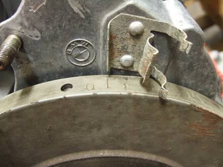

    I’ve taken the radiator and fan off and hand cracked to TDC. Timing marks on the covers look ok? Is this a fair guide or should I bite the bullet and take everything off again?

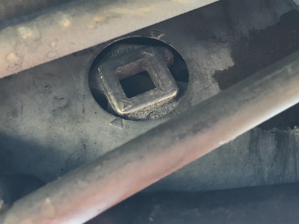

        I ended up taking the timing belt cover off and confirmed that the timing marks are spot on. Relieved and can proceed with troubleshooting without second guessing.

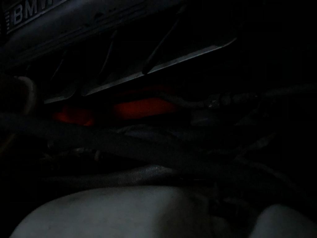

            Was trying to bleed the cooling system and I noticed that the the exhaust manifold was glowing red hot. Have never seen this before. I’m suspecting some blockages in the cooling system preventing water circulating around the block. Has anyone experienced this before?
            Have ordered a coolant system ‘flushing gun’ to see if this helps.
            One step forward. Two steps back...
            • digger
              • Nov 2005
              • 6163
              Glowing exhaust at idle is usually due to incorrect ignition timing, specifically not enough advance and the charge is still "burning" as it blows down into the manifold. An excessively lean or rich mixtures that slows the burn rates on a couple of cylinders can produce the same effect.

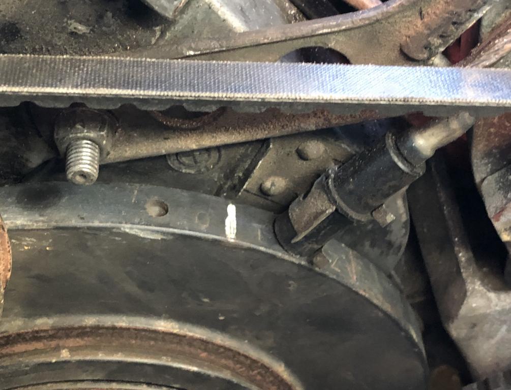

                        You are spot on. 19 degrees at 3000rpm is what’s on the sticker.
                        Have given it a go tonight but I can’t seem to adkust this correctly.
                        I bought a timing light and it allows me to adjust the degrees. Am assuming I just set this to 19 - get someone to idle to 3k and the mark on the vibration damper should line up as per the attached picture. I’m about an inch to the right of that line and can’t turn the distributor any more.
                        Am I using the timing light correctly?
