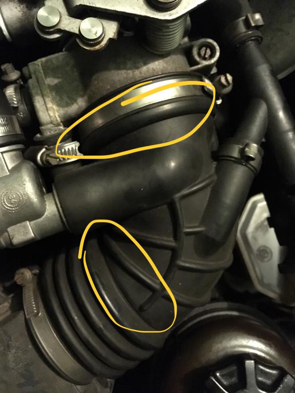

                          Had a good look around, found the spark plug wire on cilinder 6 had a crack in the isolation (not too bad but still) and they look pretty old so considering I already replaced rotor, cap (which were pitted) and plugs, might as well bite the bullet and also replace all the leads.
                          Measured resistence on the coil and got 1,5 ohms on the primary circuit rather than the 0,5 ohms Bentley manual quotes.
                          So i guess I’ll replace that as well, or is it ‘within margin’? My multimeter is pretty cheap...)
                          Also noticed 2 slight cracks (don’t think it’s all the way through though) in the intake rubber boot, see attached picture (hope it’s sufficiently visible). Should it be replaced?
                          Also paid a bit more attention to the poor running cold engine and actually besides the symptoms i mentioned one other thing it does is rise revs, lower revs, rise, lower, etc.
                          • e30davie
                            • Apr 2016
                            • 1788
                            there must be ZERO air leaks between the AFM and the engine. So yep, replace that rubber hose.
