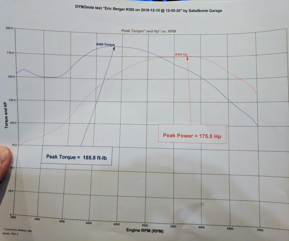

    The car pings pretty bad when it is hot outside even when running rich. And I'm clearly not getting the peak horsepower for that amount of torque.
    For a healthy engine what do you think is limiting the power?

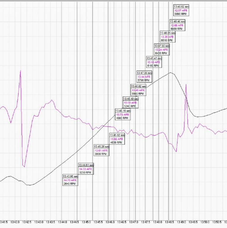

      Doh I messed the afr numbers. Plz see the graph, the are good 14-13 throughout the pull

        the afr numbers are from a tailpipe sniffer? They can read leaner than a wideband closer to the motor by .5-1 AFR.
        Are we also assuming the valve clearances are within spec?

          as to the question that's limiting power
          - AFM, piss it off and get a standalone and a good tune (why use agricultural EFI on a big $$ rebuild)
          - stock intake limits power alot but you are still down on whats possible
          - 272 cam is too small (not enough lift or duration) to make it peak hp rpm near what it does with a smaller engine when used with stock manifold.
          - are your pistons generic type? that might be why youre getting pinging and why youre timing is not allowed to be optimal
          - who did the head?

            Jaxx, the numbers are from the wide band o2 just past the x pipe. pre-cat. Yes, valves are dead on .01+-.002" and i don't have the timing map. the tuner has that but i think we need to do more work on the tune.

              working with what you have i would check cam timing to see if its advanced. with a small cam like that it will want a bit of retard to it if you want it be happy pulling to 7k.
              AFR look fine, the timing probably still needs to be optimized.
              you could probably conceal a PNP MS setup pretty well if its purely visual, even a gutted M30 AFM to make it look period correct
              its true that a stock manifold doesn't like much overlap it makes idle and low speed suffer, and that will be the case if you go upto a 288 but there is some middle ground.

                      I like to be at 12.5 or 12.3 for an NA street car, but I'm paranoid. Remember your O2 sensor is an average of all cyls. In general you tend to not see much of a difference in power being a little richer than needed, but it's safer. Timing is where you make your power. With that said, in my (limited) experience these motors will handle leaner conditions (~14.0 at WOT) in stock form without issue.
                      It really may be that the cam you have is not great, but I am not well informed on cam profiles for the M20 and what exact profile your 272 has. I agree with digger regarding cam timing--if you shaved the head you're advancing the cam timing as the chain length is shorter.
                      Regarding ignition timing, if your tuner at or over 30 degrees by 3-4k rpm I'm sure it's within the ball park. If not, I would add timing 2 degrees at a time until you stop picking up good power--unless you have some sick coated bearings and wanna run on the ragged edge with pump gas

                        Did you set the cam timing by measuring the valve/cam lift? Maybe the cam timing is more advanced than optimum for top end power.

                            I don't have an adjustable cam. It's set to factory cam settings.
                            its probably a good investment, for example there are a few members who found that with the 284/272 cam that several degrees of retard made more power than as installed with factory marks. when i plotted out the cam it showed that the factory gear would mean the cam installs advanced alot so retarding the cam from the factory marks would mean it is installed as recommend by schrick
