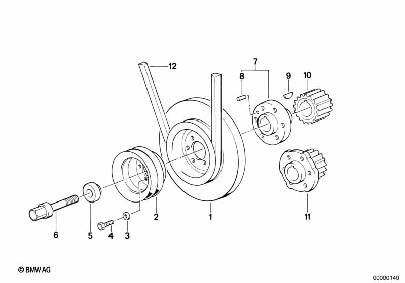

                          I have questions.
                          Do you have to take out the woodruff key (number 9 on the picture) on the crankshaft to change the crankshaft seal?
                          How do you insert the timing belt gear wheel (number 11) back on the crankshaft?
                          The crankshaft bolt is short.

                              Woodriff key does not have to come out, the seal rides on a thicker part of the crank snout. Don't forget the oil pump drive seal while you are in there (same part number as the cam seal).
                              I made that tool out of a scrap piece of 1/2" aluminum and a band saw, use and loan it to my friends all the time. Since you motor is in the car, you can wrap the tool with some towels and let it rest against a frame rail.
