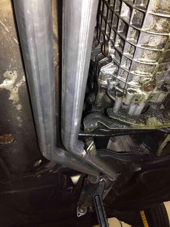

    replied

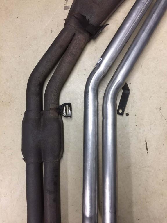

    Check the part number for the cat section on realoem for auto vs manual, if they're the same there's your answer. The bracket required serious twisting to fit btw, you can see how its off in my pics. No welding, just twisting.

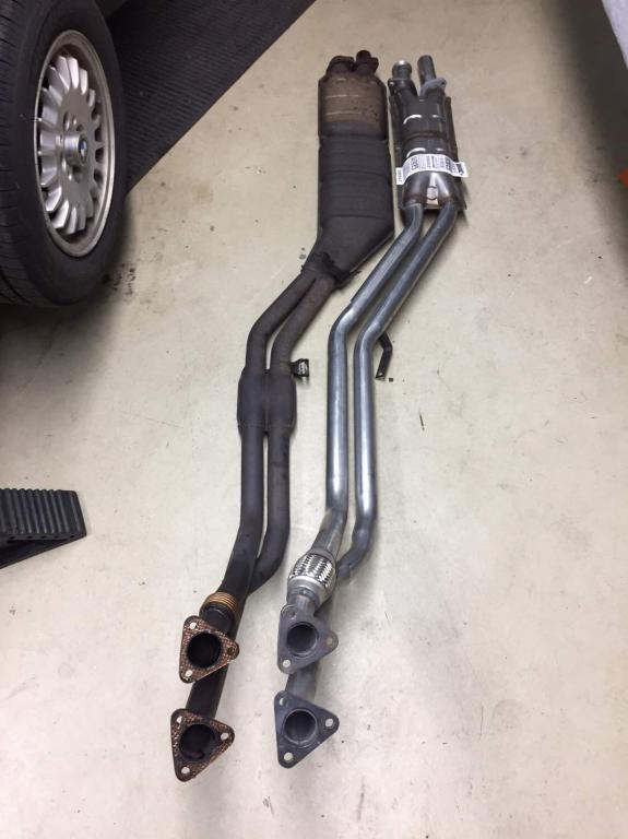

    replied

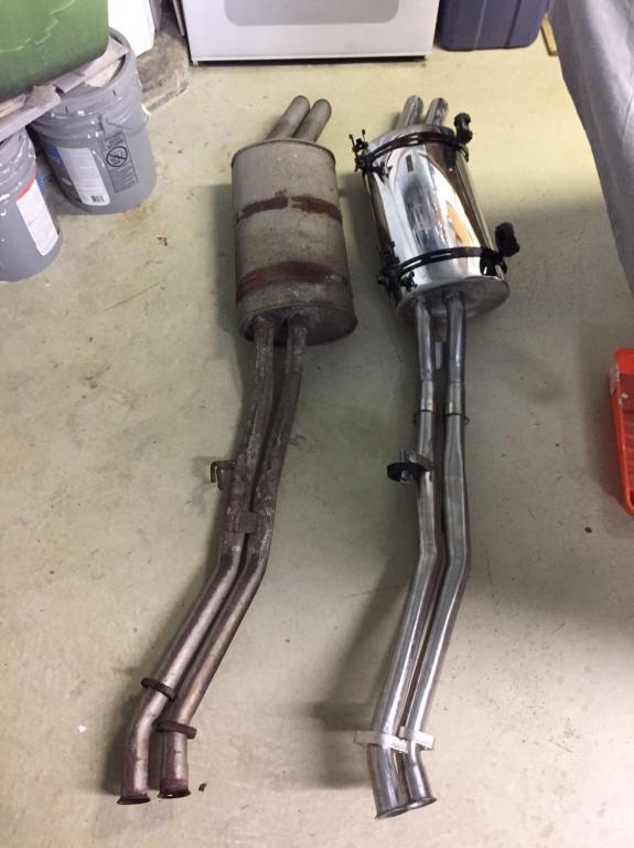

    Exhaust is up...
    Exhaust work is never fun. I suppose this wasn't the end of the world. Took a full day working alone except for ten minutes at the end where a neighbor helped me hold the muffler while I fastened it.
    Lessons learned:
    1. Should have bought a new rear muffler heat shield. I ended up reassembling w/o as mine was more crust than steel. Think this is the part but really don't have the appetite to drop the system again to reinstall. https://www.fcpeuro.com/products/bmw...te-51481945429
    2. Assemble rubber hangers to body then muffler to pre-hung hangers.
    3. Fit at the catback-cat donut gaskets is fiddly, I had a leak at first then slacked, tried to re-align, tightened, metal-pounded and it seems good now.
    4. I believe the muffler I removed may have been an Ansa. The ebay/IE is no louder. Which I am cool with.

    replied
    Bracket at cat will need some work
ID:	7201023Click image for larger version

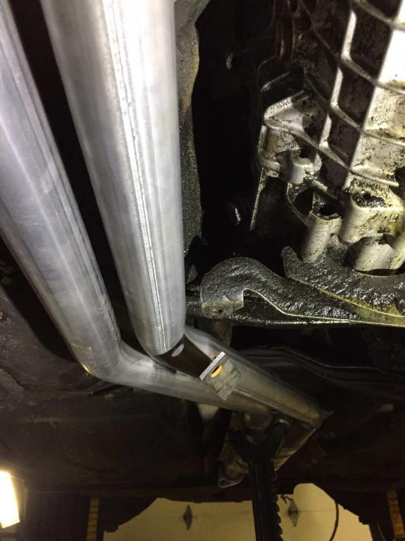

    replied
    Exhaust down
ID:	7201020Click image for larger version
ID:	7201021Click image for larger version

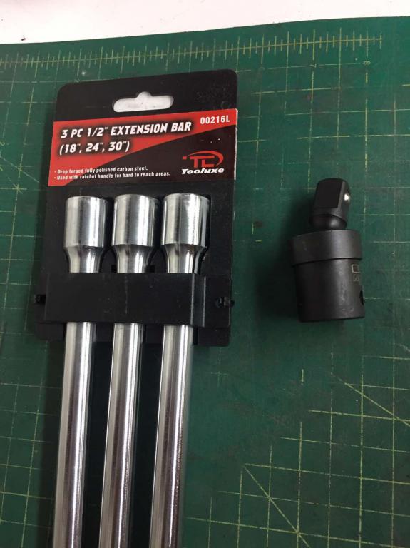

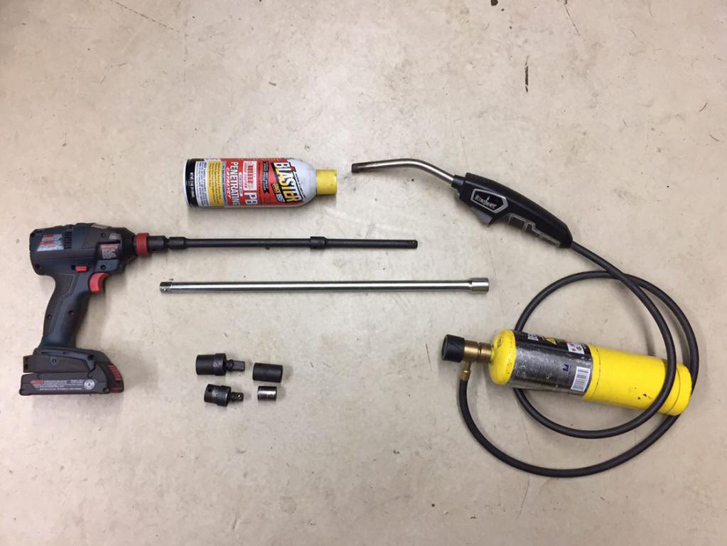

  • r-mm
    replied
    I wouldn’t call it fun but all six downpipe to manifold nuts are off. Takeaway: you cant have enough combos of 14mm (for some I understand it will be 15mm) sockets wobbles universals extensions. The most critical clearance is at the nut to downpipe flange so I would say having the lowest profile sockets and joints. Note the difference between a universal and wobble. I did the unthinkable (gasp) and used non impact sockets with the impact once on account of it is thinner.

  • r-mm
    replied
    Gaskets and DEC cat pipe in the house. Exhaust replacement will be this weekend.
    I am getting slightly cold feet about running the extremely light RHD flywheel as this will be a daily driver. SSSquid says they'd tune for a 900-1000 rpm idle to compensate. i reached out to a few on this board who installed the RHD and got generally positive feedback - interested to hear from anyone else who has installed it.

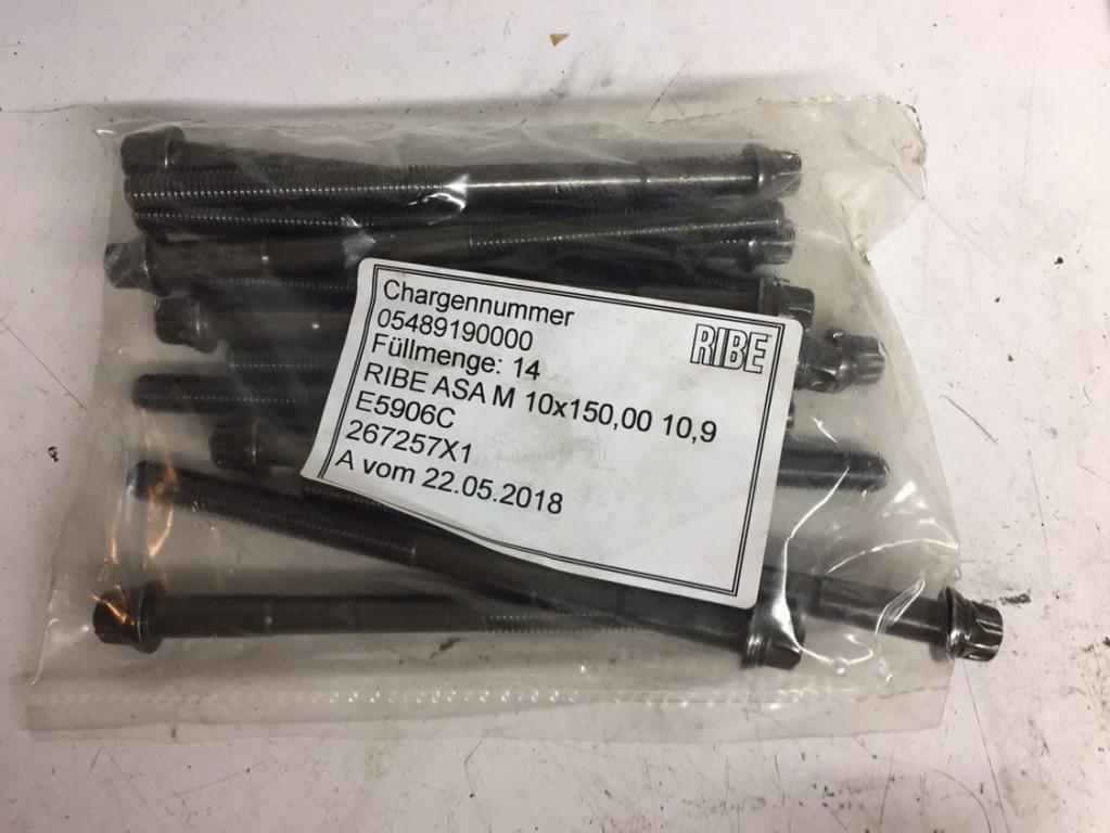

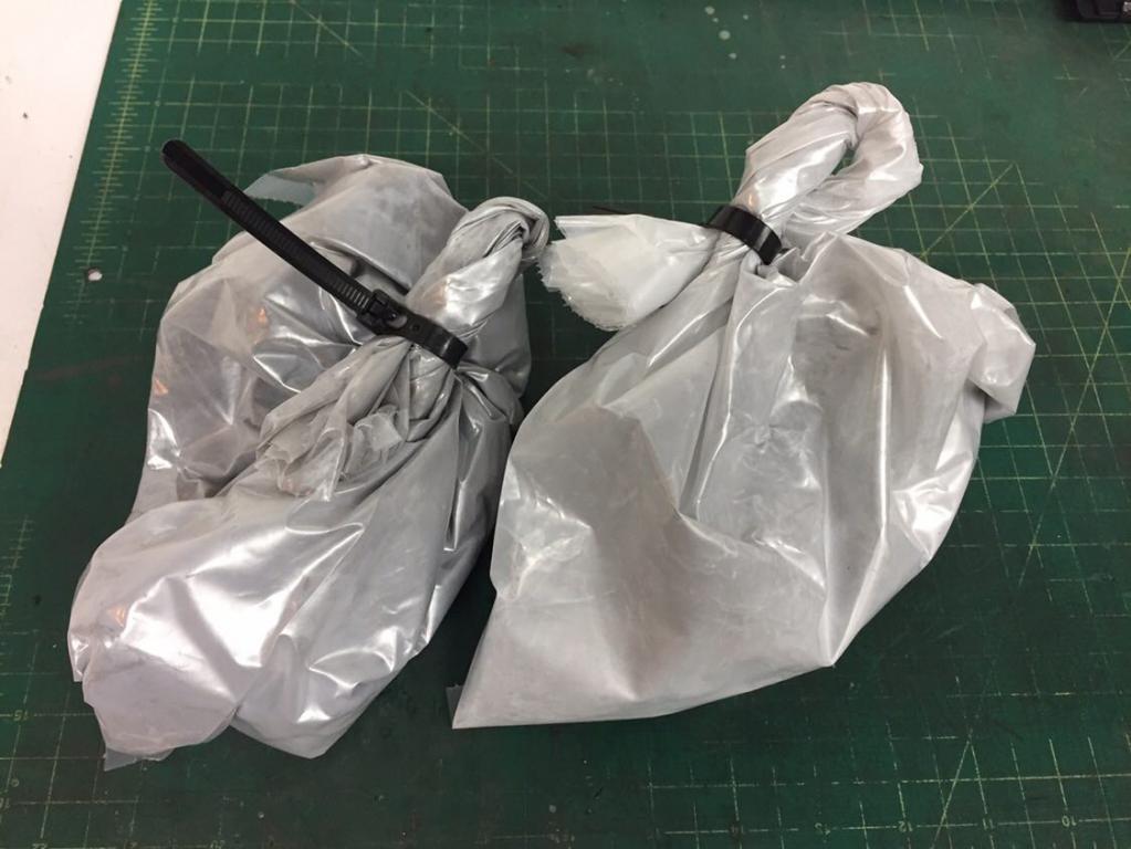

  • r-mm
    replied
    Tooling up...

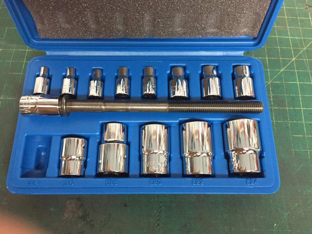

    Forgot I don’t have external Torx for the new head bolts. E14 is the socket needed fyi.
    Some long extensions and wobblers for the exhaust downpipe.
    A few powders to try and get a nice natural alum look to the underhood bits.
