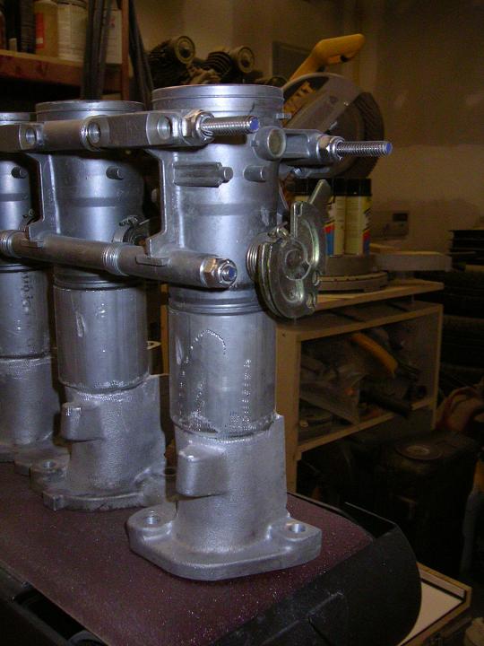

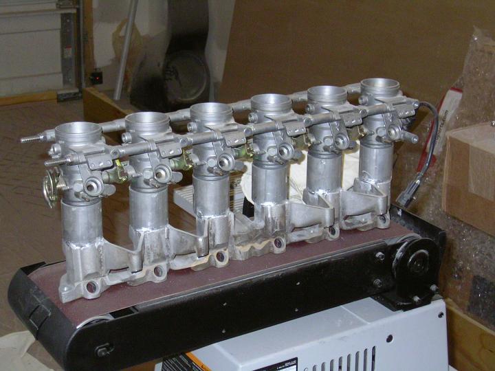

Yes, a vacuum pipe is connected to each throttle body after the throttle plate.
The black "thing" is the injector and the other pipe collects vacuum
Here you see two connections that come off the main vacuum collector pipe. There is one more at the back which I think goes to the brake booster.
