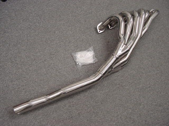

                      Originally posted by dele30
                      So the IE exhaust did nothing for performance? WHY?
                      If get a set of headers that will increase my Performance?
                      What set do your recommend?
                      IE sells long tubes.....and look on the gee bay for a SS knock off....I have em and they have been getting good reviews.....mine r not on yet.
