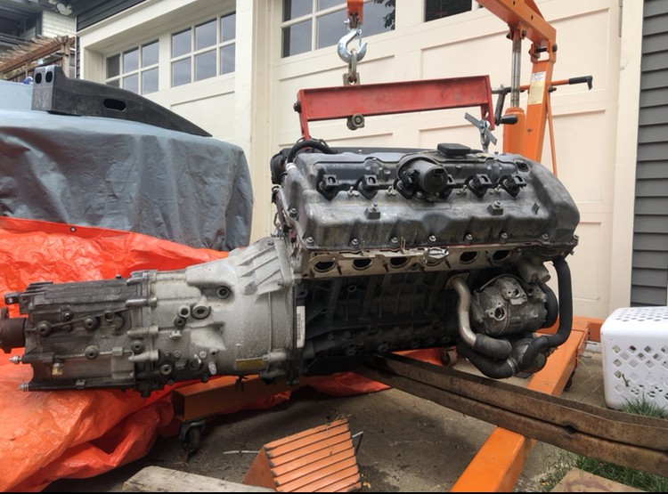

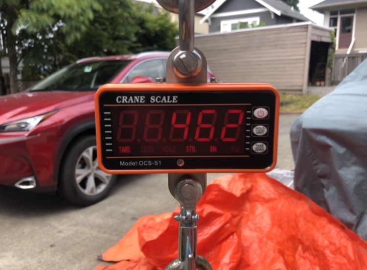

                      Reviving a dead thread that was the first result in a search for engine weights. This is an N52 and ZF 6 speed fully dressed except for fluids, engine arms, exhaust manifold, and wiring harness. Balance bar was tared out and weighed about 13 lbs. Click image for larger version
