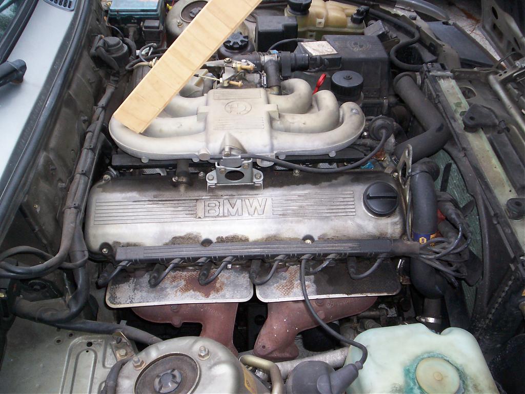

                    im gonna do this soon, i head, 1.3, I intake mani., i exhaust mani, fuel rail, injectors, harness.
                    gonna be good.
                      here are a couple quick engine piscs. nice and dirty for ya. id like to do this to my car. but its not going to happen till the start of the new year. it eases my mind that i wont have to hack the harness at all.:D
                        gonna be good.
                        Oh it is, keep us updated with your progress on your 87 325
