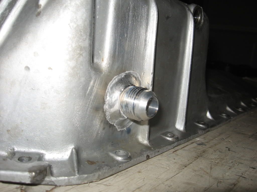

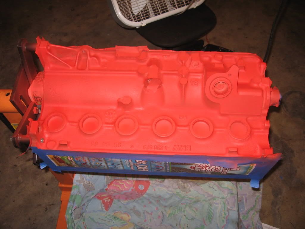

    Here's the scheduled update for today.
    New oilpan, with pretty bung welded onto it. No leaks this time.
    And I started painting the "redblock", in honor of the $500 1985 volvo wagon I had been daily driving in the e30's absence.
    Not exactly the same shade they used on the volvo redblock, but the symbolism is all still there.

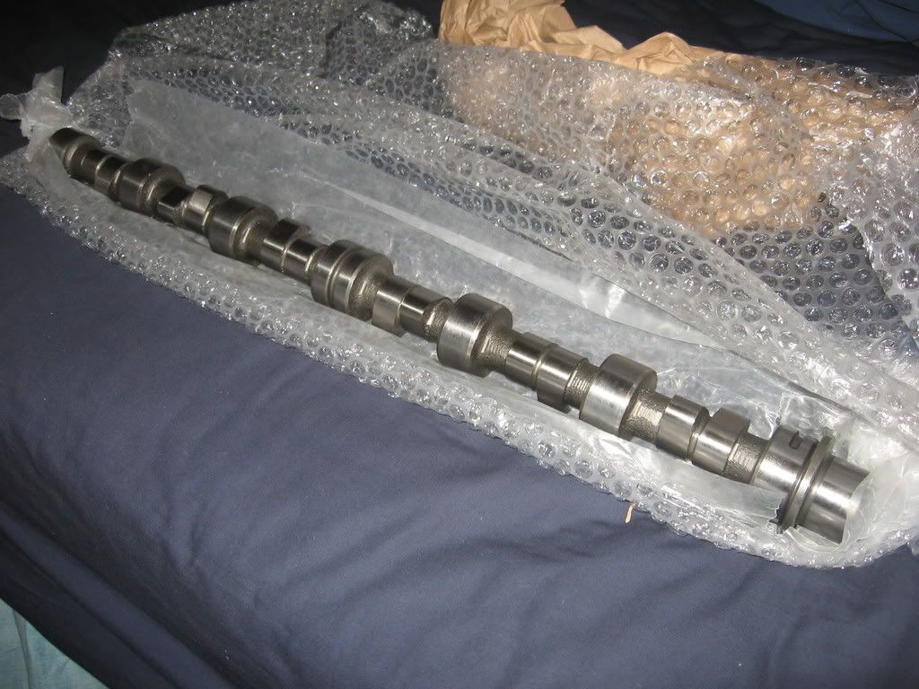

    Anyway, this came in today:
    It's just a stock camshaft, totally fine for my power ambitions. $189 shipped from azautohaus.com.

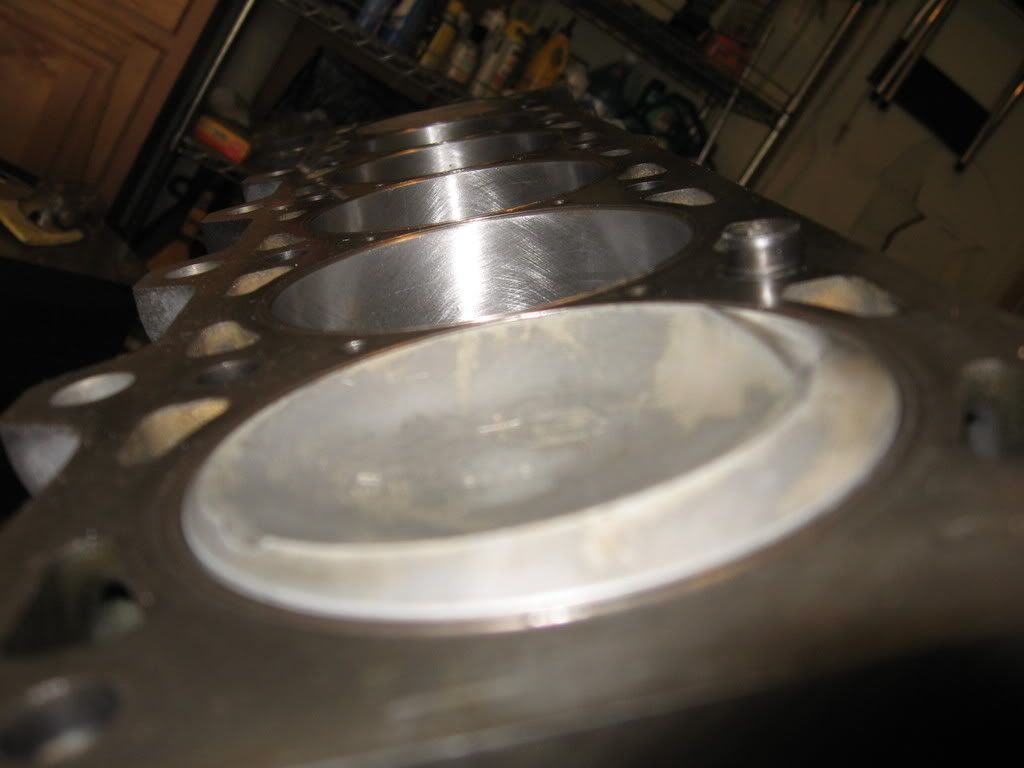

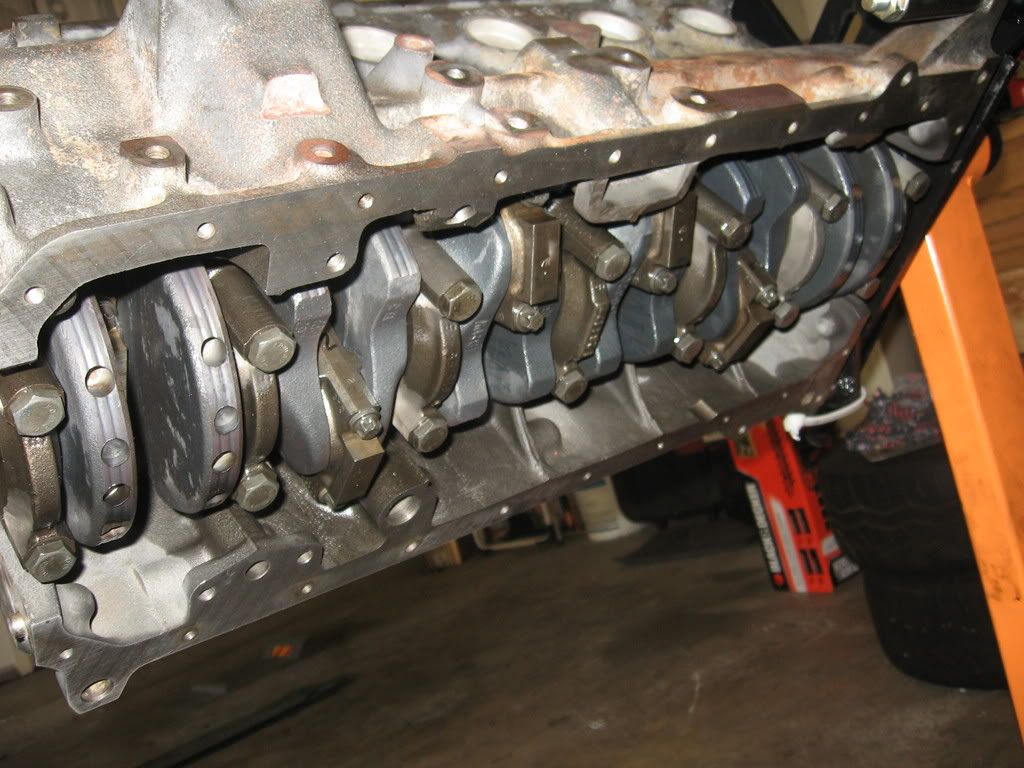

    Here's the new block. Honed, o-ringed, cleaned and rebuilt with new bearings and 2.7L internals out of an S-ETA.
    The head has been decked and will have a new camshaft and rocker arms installed. Hopefully get it back together this week.
