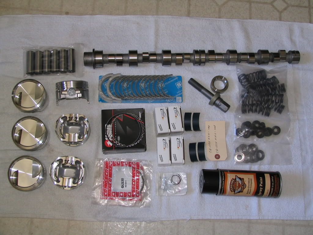

    Metric Mechanic Sport 3200 (86mm obviously, and deep pockets = no interferencee) Pistons, wrist pins, moly rings, Metric Mechanic "Rally" cam, bee hive springs w/ retainers and base, main bearings w/ 360 degree oil groove, coated rod bearings, oil seal spacer (comes with a longer bolt), and one can of Harley Davidson TEXTURE black engine paint. That's the stuff that looks like sand, and is for the valve cover.

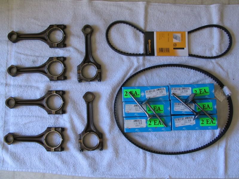

    Stock S50 rods, Conti alternator belt, Conti timing belt, intake and exhaust valves.

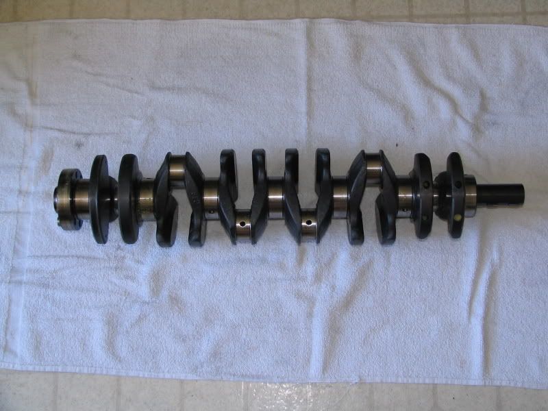

    The heart, S52 crank. It's in great condition. Right now there's just a lot of fiberglass packing stuff sticking to it from the crate.
    ...and weighs about ~48-49 lbs. Does anybody know what the stock M20 crank weighs? I'll know shortly anyway once I take it out and weigh on the same scale though.
