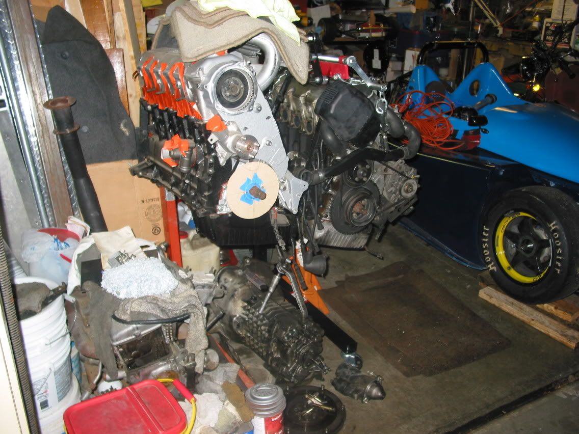

    Oh I forgot. I got my crank and ARP rod bolts in yesterday from the UPS guy. ARP doesn't make bolts specifically for the S50 application, but I read that the kit for the LS1 fits. They're 3mm too long, but the threading is .8" IIRC so there's still full thread engagement.
    After I got home from work I took off the tranny, clutch and flywheel then mounted it up on another engine stand.
    Here's how they sit right now. Ignore the messy garage :P
