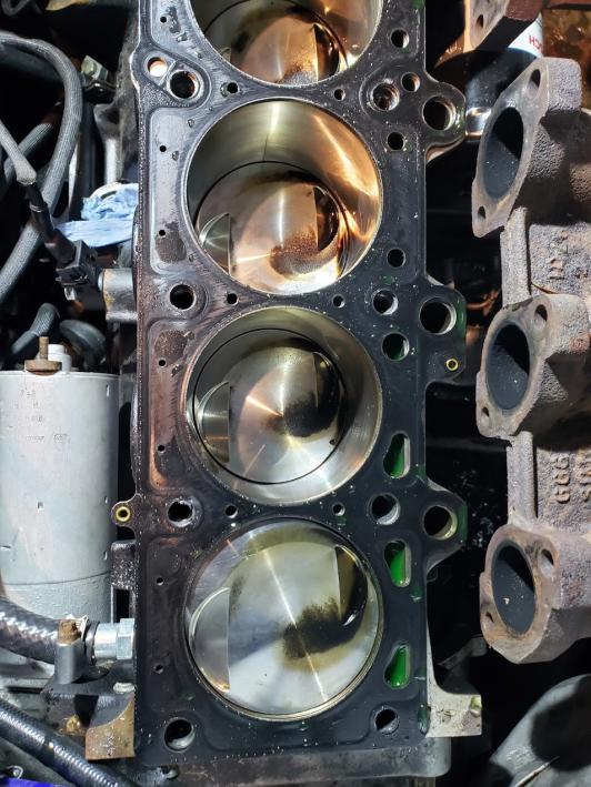

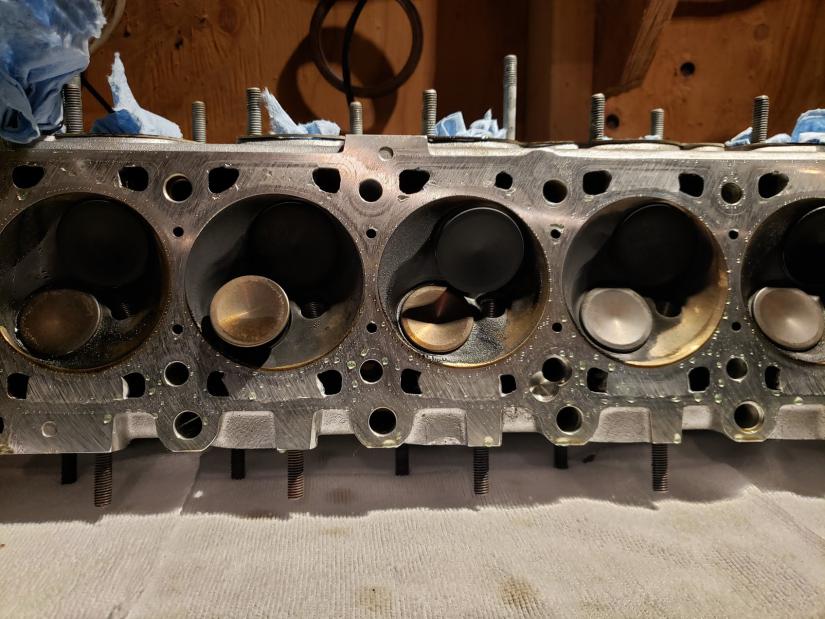

          So, the head is now aligned!! It looks like it was off by 1-2mm... definitely less than ideal. I am lucky it didn't result in piston to valve contact...
          Overall a pretty good weekend, although I would love some feedback on the oil filter debris (posted after this for additional attachments).
          So, previous to this weekend I had ~50km (probably more like 35) on the motor, plus a bit of idling time. Shop here is busy at the moment... and my buddy up island needed a hand getting his other touring going, so I decided to brave the highway up island to his place. Distance there is 225km.
          The drive went well. Ran the entire way with autotune running, and other than some issues with idle control the motor seems to be doing well. Motor felt fairly good, if definitely quite un-tuned in the top end. Didn't want to spend much if any time up there until re-aligning the head.
          Managed to get the head off and took a good look around. No obvious red flags. Cylinder 4 there is a small score line, which can unfortunately be felt with a finger nail (just barely) right at the very bottom with the piston at BDC. Seems to be un-feel able just a small ways up from that. Some other relatively faint marks that can't be felt anywhere. Otherwise everything looks pretty good (I think). Definitely no valve marks on the pistons (or valves) and I gave everything a bit of a wipe down before re-assembling. A fair bit of oil in the intake, more than I expected given I am not running the breather hose back to the throttle body, but got some second opinions on it and it is likely just due to the fresh rings. I certainly have not noticed any evidence of oil (or coolant) in the exhaust. A bit of 'smearing' on the cam lobes, but definitely not anything that can be felt.
          Got the head back on, all went fairly smooth actually.
          Went out for a few good pulls up to ~6k in third, flesh out the map a bit. Car seems to be running well.
          Drove it home, and other than a sync loss event at like 30km/h halfway that nearly gave me a heart attack it went very smoothly. Likely need to fine tune spacing a bit on the hall sensor I am using for crank position.

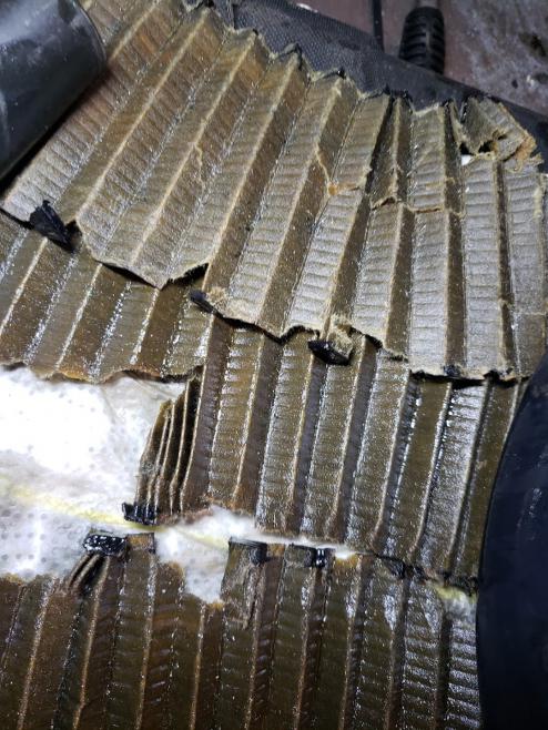

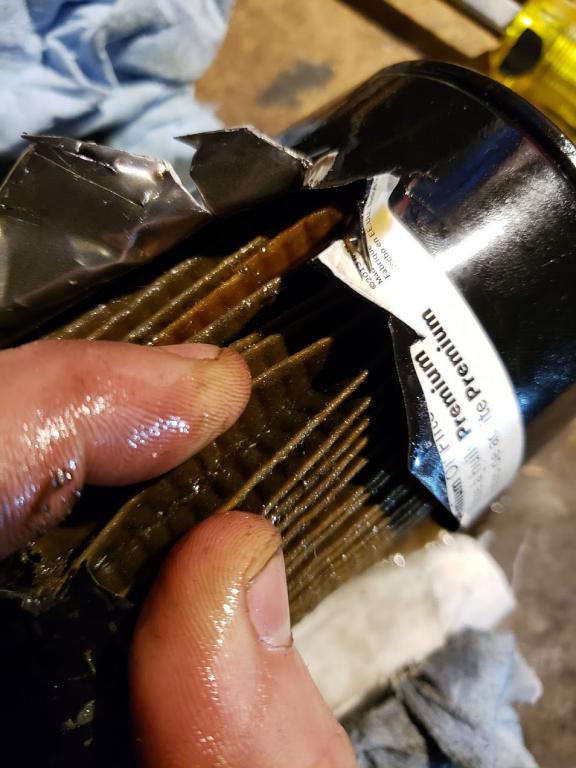

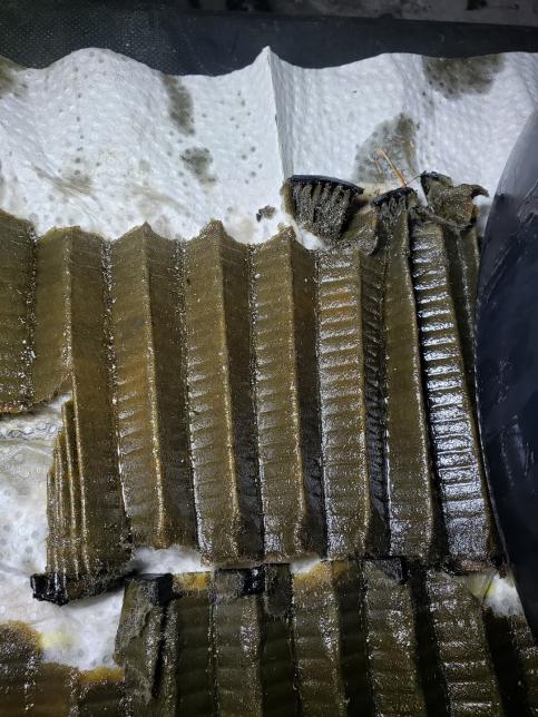

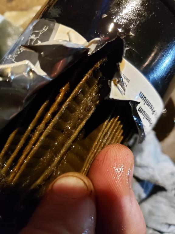

            Also, here is the oil filter:
            -It seems the shavings are non-magnetic. Tried with a fairly strong shop magnet used for bolts, but nothing seemed to want to stick to it. Shavings were quite small though, so maybe just stuck in oil, but even when pulled out and onto my oily fingers the magnet would not pick them up.
            -Looked like nothing at all except *maybe* some extremely fine dust on the magnetic drain plug.
            -This is the third filter and oil change. First was immediately after running the car for 10 minutes, second was after about 30km of driving and messing with tune, then this one after ~240km of driving.
            -Definitely some larger black flecks in the filter that are permatex.
            -Unfortunately we used a very dirty oil pan with a bunch of shavings and bits already in it... bit of a screwup on our part as it makes it impossible to tell if something made it into the bottom of the pan or not. For the record though, the last two changes I have used clean pans and there was nothing visible except at best the occasionally sparkly bit the size of a dust particle.

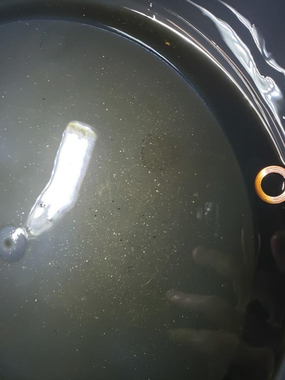

              More oil filter fun... Changed the oil again. So this third time around, there is a total of around 650km on the car.
              I feel like there is too much debris... it doesn't seem to be magnetic, at least none of the larger visible flakes (they stick to my finger better than they stick to an oily magnet) but when I put the magnet down in the empty pan with a thin film of oil in it I could definitely see tiny, not even really visible except when the light hits them particles shooting into the magnet. Took quite a bit of dragging it around for there to even be any visible build up on the magnet.
              Anyway, I am not too keen on there still being visible bits. I did re-use my old oil cooler without flushing or anything, so maybe some crap came from there, and there are still a few Permatex bits in the filter (much less than last time), but the larger metal shavings are obviously concerning. They look like aluminum, but that does not make much sense to me.
              At any rate, no audible knocking yet... maybe I will spend a while poking around with the stethoscope while she is idling.
              Also, changed my FPR with the replacement Nuke sent me, will verify if that has resolved my fuel pressure issues soon. Redid my plug wires, was not happy with the bends in the plastic sheath. Also determined my #4 plug had a poor connection (some evidence of arcing) at the coil pack, so I need to keep an eye on this. For now tried just squeezing the connection with pliers, but I am going to be getting new plug ends in (ones with the separate crimp section for the wire, I really am not a fan of these with the fold-over crimp where the conductor is between the insulation and the crimp) before driving the car further than up and down the hill into the shop.
              Again, seems like the visible bits in there are not magnetic... or if they are, they are only extremely weakly and will stick to my finger over the magnet. Interestingly enough the larger black flecks (Permatex) all seem to be extremely magnetic.

              Top, less oily filter in this picture is the OLD filter from the second change, for comparisons sake.
              May not be easy to tell from the pictures - but I would say generally there seems to be a fair bit less debris in the third oil filter, although there were a couple of folds that looked comparable in terms of crap to the 'average' of the second oil filter.

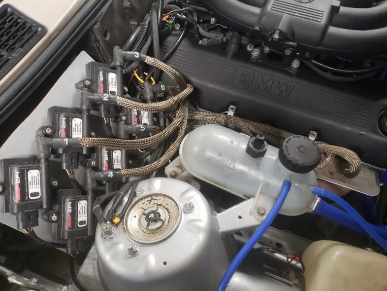

              Plug wires redone. High temp sheathing, some heatshrink and fancy stainless steel cable ties. In other news, valve cover is STILL slowly leaking, been around it 30 times already, even to the point where I stripped and had to replace a couple of nuts (slowly tightening by hand after torque wrench pass did not stop leaks). I think the IE head studs are indeed slightly too long, so I am probably going to have to drill a few select holes in the VC baffle... fun stuff.
