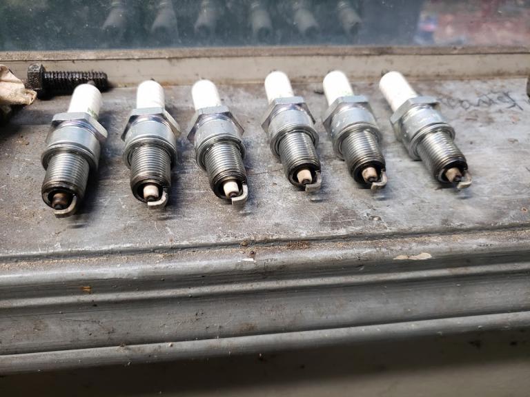

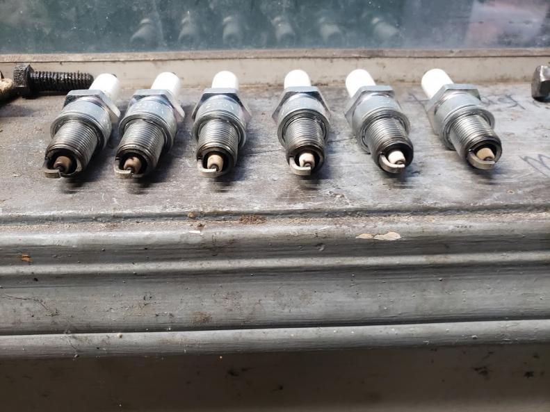

    • My plugs seem to be all over the place. I have attached a couple pictures of them - cylinder six is on the left, one on the right, six seems a bit fouled.
    • I may be reading too much into this... but the AFR gauge, under my relatively steady idle conditions (@1300rpm) seems to be spiking every 1.8s, which to me indicates a single cylinder is under fueling (based on plugs, probably *not* six... which looks to be overfueling :/). I don't know if this is an issue with the IDs or not - my understanding is they are relatively good at low pulse widths, and I believe I have the low pulse width control setup properly in the MS, based on the data they have online.

    These are the plugs (6 - 5 - 4 - 3 - 2 - 1 left to right)
    Click image for larger version  Name:	20201028_162500.jpg Views:	0 Size:	71.0 KB ID:	9958124
    Click image for larger version  Name:	20201028_162543.jpg Views:	0 Size:	69.3 KB ID:	9958126

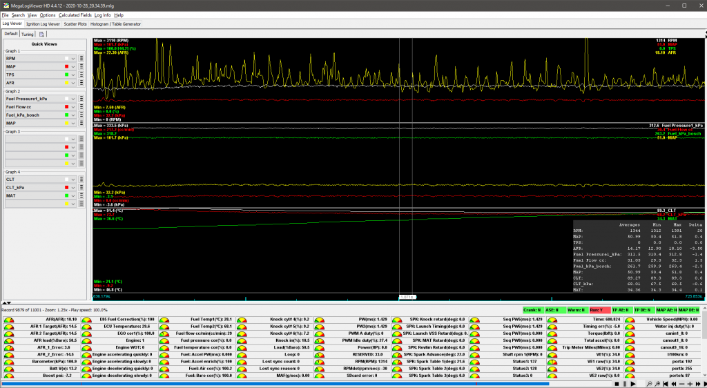

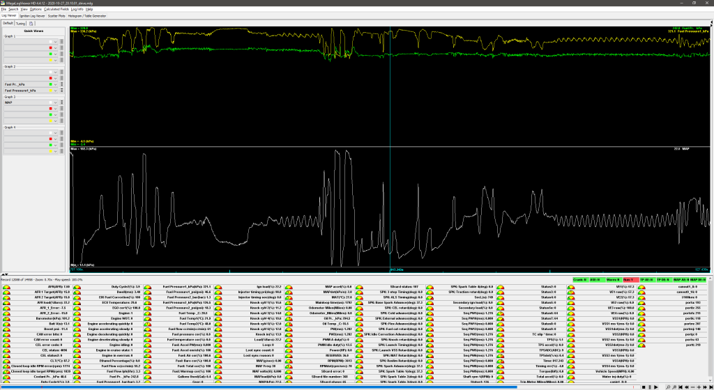

    Here is a log snapshot. This is after quickly dialing in VE around where she was idling to keep things in the AFR gauge range. I think the gauge is working fine and telling me something else is wrong lol. Note that the pulses are almost always ~1.8s apart, with some occasional other odd behavior.
    Click image for larger version  Name:	more_idle.png Views:	0 Size:	264.0 KB ID:	9958127

        Definitely sounds like there's an occasional miss, that'll throw the AFR readings off. Fuel pressure looks pretty stable in that log snapshot, 12kpa high really isn't that much, that's under 2psi and probably within the tolerances of the fuel pressure regulator. Do you get 300kpa with your engine off and the fuel pump running? Pull a variable vacuum on it with a handheld vacuum bleeder pump or something you can check the steady state response of it with no fluctuations due to injector operation. Assuming the inputs are correct and the pulse widths are accurate, your pulse widths are fairly small, I'm seeing 1.429ms in that log capture, but you mentioned even shorter pulse widths before. A quick google search didn't yield the minimum pulse widths for your 1050X injectors but 1.3-1.4ms seems to be close if not in the region of instability on the stuff I did see on the injector dynamics website. IMO you're really pushing it at idle with such large injectors on this little inline six. Have you tried just making it idle really rich to see if it runs nicely at a consistent indicated AFR? You might just have to idle rich to get the pulse widths up in an area of consistent response. I've tuned cars where the owners overdid the fuel injectors and it just had to idle in the 12s to keep the pulse widths where the injectors were happy. Try bumping your VEs up while idling until you see 1.5ms or so and see what it does. You have like 700bhp worth of injector on E85, you planning on using all of that?
          This snapshot shows my concern with the fuel pressure - yellow is the calculated FP (i.e. what injectors are seeing), green is the bosch PTS pressure on the fuel filter, a fair ways upstream from the rail. White is the MAP. This is over a drive I did a couple of days ago. I am concerned by how much the yellow line is jumping - some of the worst min/max I am seeing is 240-330kPa, which seems extreme. Often if looks like the FPR isn't even responding until the MAP gets above 80kPa, which doesn't seem right to me (but I am not an expert), which is indicated by the oscillation in the yellow line while the green (fuel pressure relative to atmosphere) just stays constant.

            Well well well... here are my extended lunchtime test results:
            First off, vacuum: I tried a few things after I got the car to a semi-stablish idle, such as dumping water on vac fittings, a propane torch, etc. No noticeable change at all. Not totally ruling out a vacuum issue, but so far it doesn't seem too likely.
            Next up, injectors: Went through the harness, everything seems to be connected. Next step was some logging and tweaking. I ended up enabling individual pulse width control for the injectors and going through and bumping them one by one by 20%, after once again reaching a stableish afr at idle.
            Click image for larger version  Name:	inj_test.png Views:	0 Size:	135.1 KB ID:	9958165
            There definitely seems to be something up with injector 6. 1-5 all immediately and noticeably dropped the AFR considerably when adding 20% more fuel, as expected. 6 just .... didn't. I think it moves a bit, 'on average', but definitely not the same behavior.
            This makes me wonder if it is partially plugged or something. Only thing I can't get my head around is that the plug looked pretty rich for cylinder 6 - if adding extra fuel has no real noticeable impact then why is it running rich? Maybe it is just 'stuck' partially open?
            I am leaning towards pulling and checking. I may also throw the scope on it if it looks fine, could be an electrical issue where a poor connection is limiting power available.

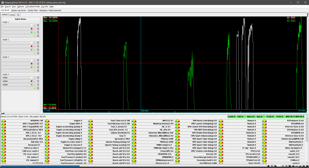

                            In other fun news, I wired in the wheel speed sensors on the front two wheels to the spare VR inputs I have. These seem to be working well, up to an apparent speed of ~19km/h (which is as fast as I can readily spin the wheel with the car hanging on the lift). Since I don't have anymore VR inputs, I ended up wiring a spare digital frequency input to the speedometer out signal from the ECU. This hasn't been tested yet.
                            Here is my really exciting passenger wheel test: https://youtu.be/Yyxst7UHBBQ
                            My hope is that the speedo output reflects the actual ~ average rear wheel speed, which with the LSD is hopefully not too bad for traction control. Later on I would like to just grab the other two rear wheel sensor outputs and get them into the MS3 directly (either via swapping those sensors to hall or VR->digital pulse train conversion). Worst case I now at least have vehicle speed, so I know how fast I was going right up until I hit a tree.
                            I also wired the clutch switch, I have to actually test it still but I did ring it out and it was working, so unless I fucked up the soldering it should be fine. This is actually the wire that ran to the cruise control ECU - so it is really a brake/clutch combination switch thing, not 100% sure it will work for my traction control needs, but I can easily rewire the other end to just the clutch switch if I need to. I do need to properly adjust said switch, it has obviously shifted a bit or something and the un-pressed clutch does not quite activate it at the moment.

                            I lied earlier, I actually hit 20.9km/h spinning a wheel by hand, not 19

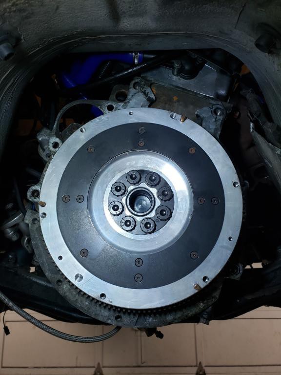

                              Fun thread. Glad to see you sorting out the teething issues. I also just built up a 2.9, but milder tuning.
                              Here's your photo of your flywheel (minus the missing pilot bearing). I'm curious about the ARP flywheel bolts you used. Did you get at least 12mm length thread engagement? I bought those same 28mm ARP bolts as well, and found that they only engaged about 6mm or so of thread length into the crankshaft. (I'm using an M52B28 crankshaft for the longer stroke). So I went with longer bolts that I trimmed to get at least 12mm thread engagement.
                                Click image for larger version  Name:	flywheel.jpg Views:	0 Size:	81.1 KB ID:	9962887
                                Are you using a dual mass flywheel? I did not measure the actual thread engagement but I would have to say it definitely seemed to be more than 6mm. I threaded them in a comfortable distance by hand before torquing.
                                **edit** NVM, just found your thread. I think I had more than 6mm (pretty much certain ...) but again, I didn't measure.
