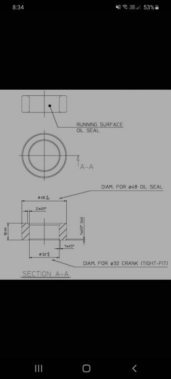

                    Also found this schematic which I believe refers to machining said spacer. Could be wrong.

                      That’s it but they don’t tell you that you need a certain nicely plunge ground 0.2 to 0.8um RA finish and heat treated to a min 45 HRC so the sleeve itself or the seal don’t get chewed out. Also a shallower lead in chamfer 2x15 is better
