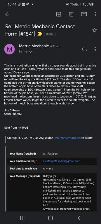

    I messaged MM regarding the required spacer and was told this setup will not work. Have also been told by a few local enthusiasts that they have used this setup and have been successful with some valve clearancing. RHD have said this setup would work. Finding it near impossible to determine who is right.
    I have already got an 325e crankshaft and the rods, trying to avoid purchasing anything else incorrectly
    If I can cannot get a definite answer looks like I'll just go back to the m20b25 rods and pistons and not bother with stroker. I have attached the reply from MM.

    It can be done 100%. The piston doesn’t pull through except maybe at 10,000rpm. In any case you can cut the crank to limit what you need to do to the piston I know a few guys in oz that used certain cranks that meant the crank didn’t need to be machined. As for skirts there are many types of skirt shapes

                You need an early Euro m52 crank, and the crank counterweights clear just fine.
                You will want to take .5mm off the block, since you added 9mm stroke (4.5mm up, 4.5mm down) and shortened the rods 5mm from b25 (75mm) status.
                The USDM m52 cranks have larger counterweights than Euro counterparts. In 1995 USA demanded all cars use the new OBD (2) system, but elsewhere BMW could keep using non OBD (OBD1) with the CPS on the front of the crank.
                The part number you need, and why, is listed in my other thread: https://www.r3vlimited.com/board/for...nd-2-8l-cranks
                I have built many 2.8l's using the e36/e46 cranks. Have both turned the crank down and re-balanced them, as well as modified pistons. Not sure why MM would think the pins would pull put of the bosses, there's still over .250" left when clearancing the skirts. He might be thinking about the s52 crank - which MM has posted on their site about using smaller wrist pins in big stroked m20's. I haven't had any issues, and one of the b28's we built ages ago is still running around, making 215+whp on modified pistons.

                  They say that so they can sell you parts
