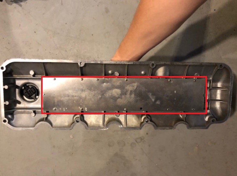

    Hey r3v,
    Does anyone know the best way to clean the gunk out of the underside of the valve cover hidden under the rectangular plate (encircled in red in the photo below)? My engine ate some bearings in the past (or someone thought it was funny to pour sand in my oil, haha...) and I'm 100% certain old oil was contaminated, so I want to be as thorough and as clean as possible.
    Are the nubs holding on the rectangular plate welded on, or can they be drilled out and replaced with blind rivets?
    Thanks,
    Mike

            I've been able to pry the cover away from the valve cover and use a pressure washer to clean the inside. No way spraying brake cleaner will get everything out of there.
            Once clean (and dry) I put the cover back on. On some rivets I used a punch to peen it over the cover again.

                    You should see the state of what is under those metal plates...
                    I had mine drilled and tapped out when I got the cover powder coated (because its safer to do this than have sand get behind the plate, which happened to me the last time I had a valve cover done).
                    Only problem is there is an expansion and contraction noise as the plate now moves when cooling down.

                        I think I may end up doing this with mine... I had my valve cover powder coated as well and am slowly approaching startup on my new stroker; I am highly suspicious that it is not very clean under there. Did you actually have issues with sand in your motor or did you just find some residue in your valve cover behind the baffles?
                        • agisthos
                          • Apr 2019
                          • 79
                          No sand in motor, but I did an M20 valve cover and noticed some blasting particles came out when it got knocked, so I then drilled out the plate and there was sand behind there. So I will never trust a powder coater again on this issue.
                          When you are spending a fortune in time and money on an engine I think its worth doing to be safe. Also, you can periodically take the plate off to clean behind it, you just need to carefully loctite those bolts when re assembling.
                          Otherwise getting the valve cover chemically dipped is the only way to clean behind the plate, normal pressure washing will NOT get the collected gunk out.

                              I think I will do the same as you then, drill and tap. I know my powder coater was aware, but even so.
