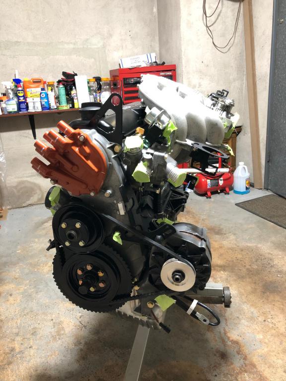

            I just refurbed my M20 and can share this photo (yes I'm running PS delete, yes I'm running AC delete). That tiny gap between the harmonic balancer and WP pulley is normal based on my view.

              Yeah it’s like 1mm or so, it is totally normal

                    Thanks! You should, it's not as hard as it looks and reassembly is easy since the BMW diagrams and tightening torques/DIYs/repair manuals are all available online. This was only the second engine I've ever rebuilt, first one being an S50.
