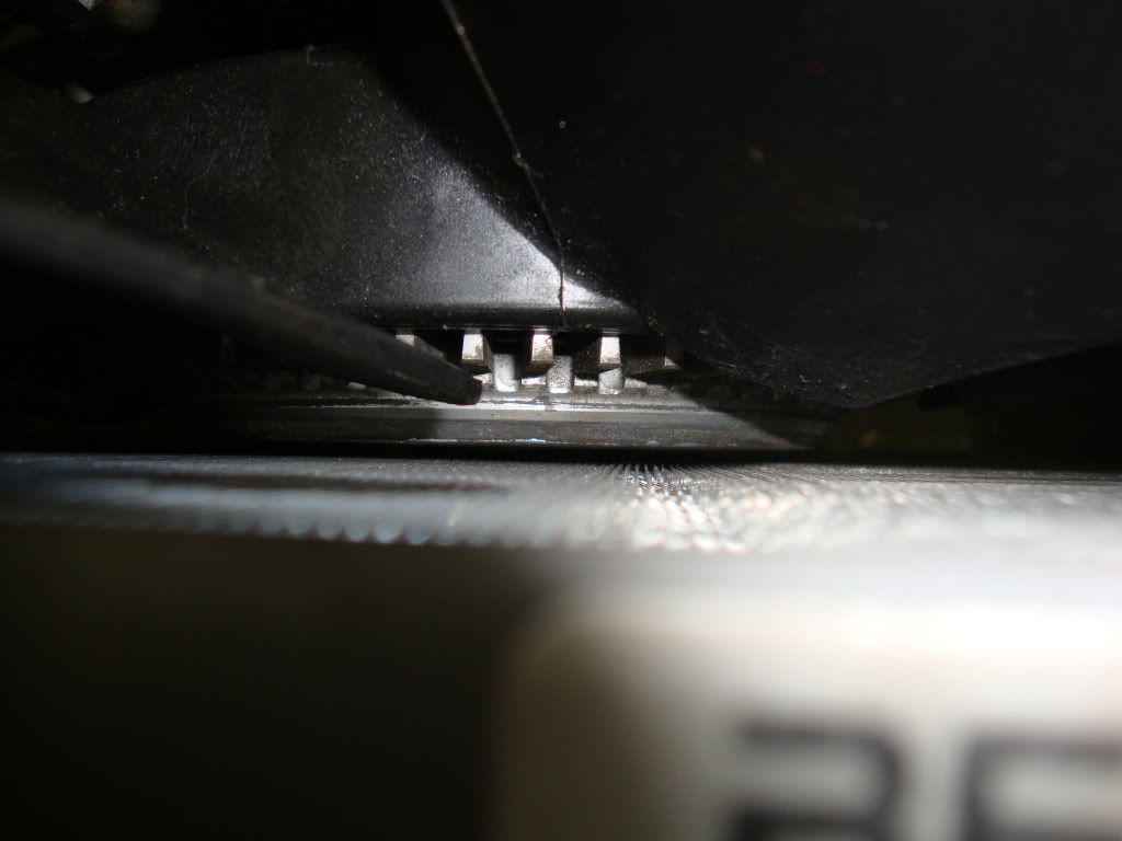

        Ok so i`ve been throwing around the idea of running the stock e34 m5 fan clutch setup on this car, but is does not fit without some adjustments. I didnt take pics of stock fan but this is a stock photo.
        After grinding off the front ribs, this is what I came up with.
        To space the fan blades back and away from the radiator I used some washers and a nut.
        And then it pushes the fan back enough
        Still very close thou :(
        I may just run an electric fan because of how close this is, I
        m just leary of an electrical fan dying on me when I have the car warming up or whenever im not there to watch the temps.
        Oh ya, don`t try to clearance an e30 fan clutch, or you will get this.
        It looks like BMW filled these things with honey !

            I hope you have solid motor mounts with the fan that close to the radiator. I would def just go electric, especially since you can run it through MS
