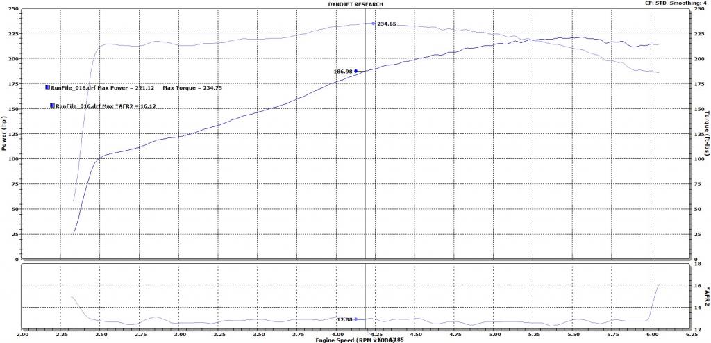

    I have finally finished my n/a m30 build and got it on the dyno. The engine was competely taken down and rebuilt and probably has a total of 5 hours on it now.
    Engine: M30b35
    Mods: 0.5 overbore, 10.5:1 pistons, 292 cam, 5 angle valve job, port and polish, custom headers, mls head gasket, balanced and blueprinted, electromotive tec2

    Wow, those are awesome numbers! That's 40 whp over what my stock one made. And the shape still looks the same, must be a lot of fun to drive.

      ^^ all those mods and only 40whp more?
      what if you put a turbo on with those mods? how much whp more than the stock you will get?
      but sure that must be a lot of fun to drive and alot of torque :)

          This is a very similar m30 build to jb325is. He he made around 220whp if I recall correctly. He posted it on here.
          My m30 has the schrick 284/280 cam and 10:1 pistons. Feels good man.

            Nice work! Those numbers are pretty close to my Schnitzer 3.7 liter M30 powered car. What rear gear are you running?

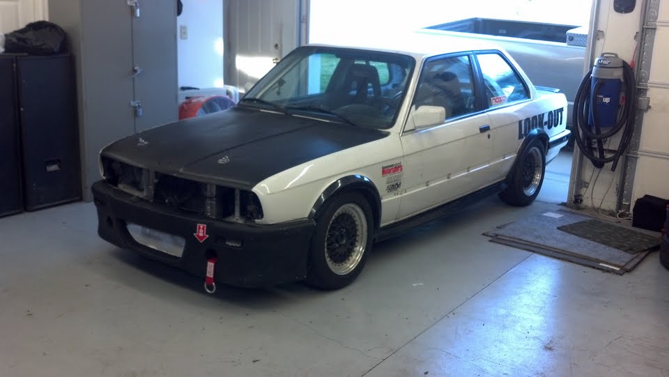

                  the car is definitely fun to drive. i am running the stock 325is lsd but might be looking to change to a taller gear. here is a pic of the car, it is a purpose built track car and i will be taking it out again on the 26th and hope to have some video of it from that event

                      has this car ever been at delta V motorsports?

                        yes, it was at delta v in order to sort an issue with the timing chain which then turned into a few other things

                            OP - nice results! Thanks for posting the dyno as well!

                            That's not exactly A LOT of mods for 40whp out of a SINGLE CAM 12v. Hard to make them FLOW more air to make more hp w/o boost.

                              I'm amazed that your torque curve looks like that with a 292. Must be a blast to drive. Where'd you have the machine work done?
