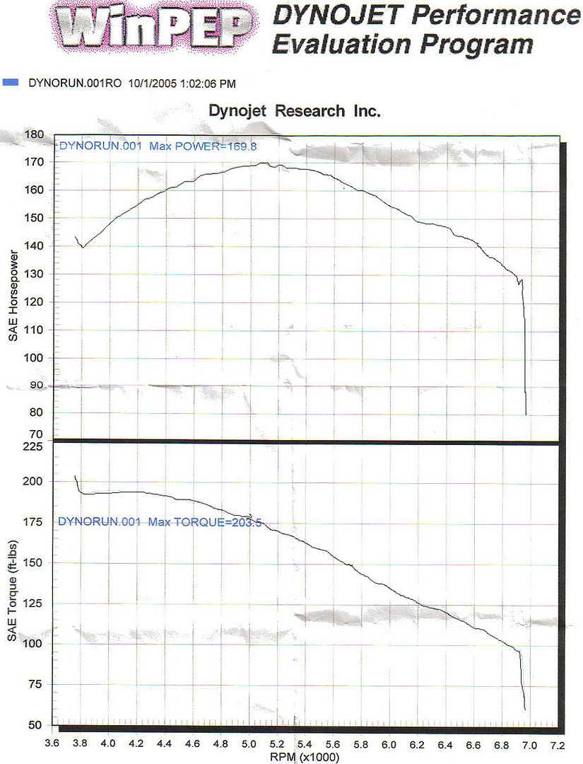

                      i have a stock internal 91 M30 with 540i injectors, 3 inch intake and ebay header/custom 3 inch exhaust w/high flow cat and chip. The thing dynoed 169whp and 200 wtrq. Major power drop after 5000rpms.
                      My buddy and I are looking to push it to about 200whp range, so any advice on your buildup would be appreciated. Thanks in advance.

                        • Zen M30E30
                          • Nov 2005
                          • 6
                          This dyno chart had to be blacklined on the photoshop to show the curve. The problem is not that it will not pull to redline, but that it loses power significantly after around 5000rpm.
                          I know the motor is running 540i injectors. The air/fuel gets a bit richer after 5000rpms as well. I think the FPR is stock. My belief is that the injectors are dumping too much fuel at the higher rpms. The ECU is running closed loop as well since we don't yet have an O2 sensor installed. The Chip is Conforti made for the M30.
                          • nando
                            • 34836
                            that is a really strange looking torque curve (most BMW inline 6 torque curves are much flatter, and wider). You most certainly need some tuning to make those injectors work properly. also, the O2 sensor is ignored at WOT.

                              I think you should put stock M30 injectors in it, and dyno it again with your O2 sensor hooked up or without one. Either way definitely put stock M30 injectors in it, and try it again.
