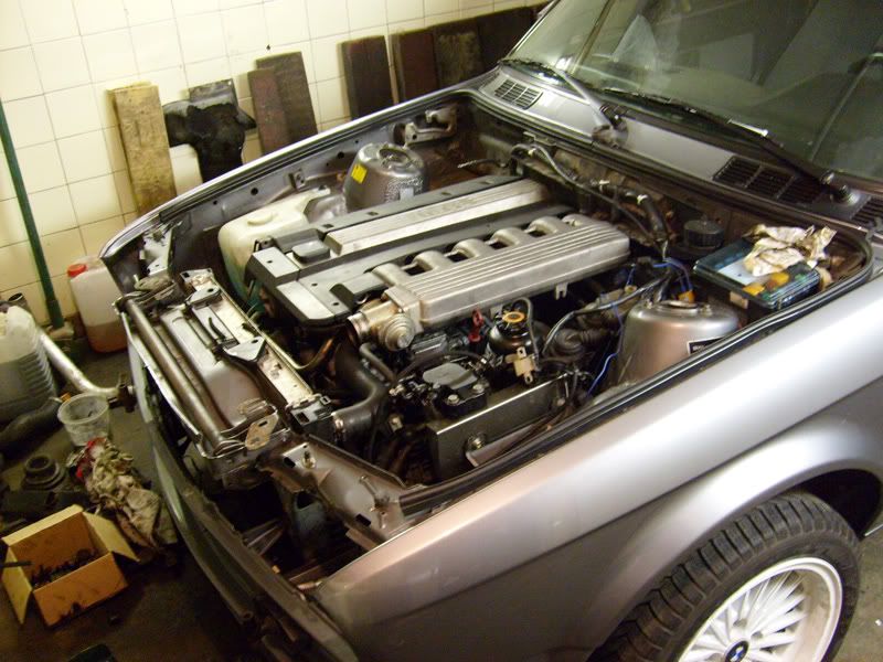

              • lukeADE335i
                • Apr 2013
                • 1386
                The M51 tds swap would be relatively easy (basically same parts as an M50 swap as far as engine mounts etc. go).

                • novanos
                  • Jul 2013
                  • 1
                  Agree, i think M51 will be much easier to swap than TDi. But TDi swap is much more interesting than M51 swap :)
                  • nick526
                    • Jan 2011
                    • 258
                    It would take an act of God to find one of those M51s stateside I think.
                      Same engine used in Rover P38s in Europe. People import them all the time. Complete TDI Rover drivetrains to swap into stateside trucks. Hell, if you have an auto car (4hp22/24), ANY engine Rover used up to about 2002 will bolt up with a bellhousing swap.
                      I'm passively prowling around for an M51 for my Rover.
