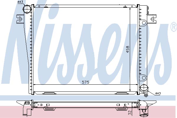

              2)The standard e28 535i radiator has frontal (2-D) surface area of 408 square inches (575x558mm). A 16" fan has an area of 201 sq in, or less than half of that. And if it's mounted on your condenser it means that 100% or nearly 100% of your forced air will be hot as balls (technical term) when it hits the radiator.
              You need to find a way of providing forced air to a larger area of the radiator, specifically the parts which are NOT behind the condenser. I don't know what the best way is because I'm still fighting that myself. You may want to look in to fitting a 324td mechanical fan and clutch; if you're running in 'position 3' it will supposedly fit: http://www.e30.de/335i/09.htm
              Try using this diagram and overlaying fan options on to it. Many manufacturers make side-by-side setups out of 12" or 14" fans that would cover more area: http://images.esellerpro.com/2489/I/287/950/R1709.jpg

                  I can't answer that, like I said you'll have to do some research and experiment. I would look for either a side-by-side setup, or a pusher fan in combination with the mech fan. Just make sure you have a good fan shroud for the mech fan, as you loose a tremendous amount of cooling capacity without one (This will probably mean making something custom. If you could measure it all out and draw it up I'm sure a sheet metal shop could fab it out of aluminum for a reasonable price).
                  One other very important note: make sure that whatever type of fan you put on the front of the car, you get it as close to (ideally directly on) the radiator as possible. If you mount a fan 1/2" off the radiator, 50% or more of the air will hit the rad and simply disperse around it, rather than going through it and removing heat. The rad essentially acts like a wall to the oncoming air; if it can find an easier path than going through the vanes, it will. It's absolutely critical to control the air and force it through the rad. A side-by-side fan would therefor sit 1" or more away from the rad because of the condenser, so you will need to build some kind of shroud/gasket to contain and force the air through the rad.
