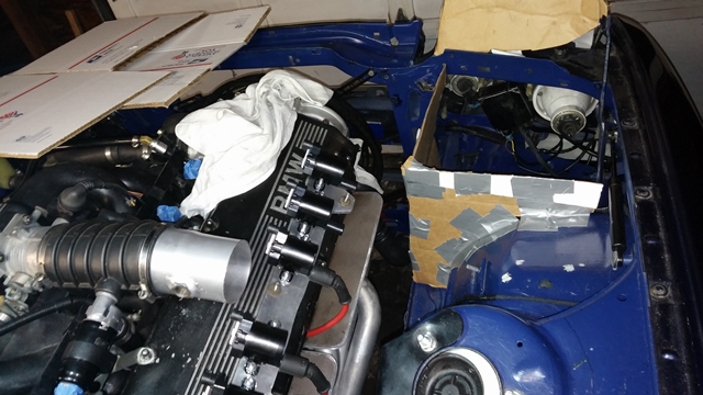

    Been doing some work on my m30. LS truck coils and airbox build. Also am selling my old B35 air box with AFe filter and larger snorkel. The subframe is not from my car but is just another project. I have a lot of work to do before spring.
    I would have kept my modified B35 air cleaner setup but the plug wires contact it with the new coil set up.

      Thanks. I will post more when I have made some progress. I am using 3" tube to the airbox and then a 6" bellmouth and a decent cone filter. The box will be aluminum with a screw on top and some type of insulation.. "While I was in there" I also lowered the steering column a bit and am adding a Tekniq QR Momo wheel but have to figure out how to have a functioning horn. Went with a Jaffster knob on a UUC shifter. After I finish the airbox I have to figure out the cam sensor location. My next project is staying stock lol

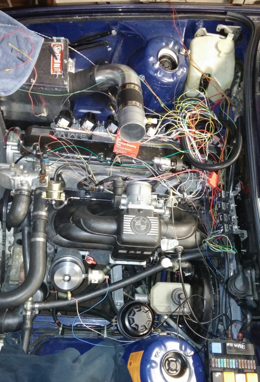

                Made some progress and changes including my cold air box, a 3.5 bar FPR, relay setup, etc. I'm still figuring out the wiring. I may get the car running and then re-do the harness later to clean it up more but that is way down the road.

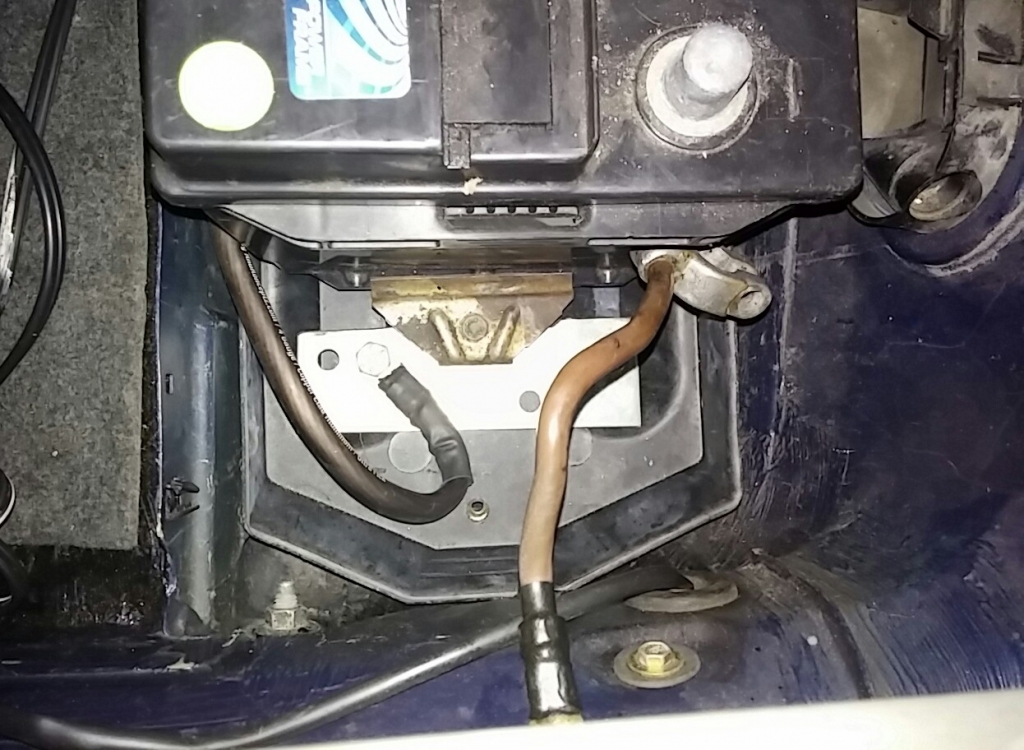

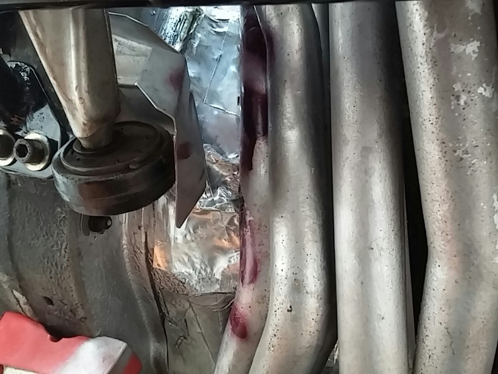

                              My battery relocation. This shows the aluminum piece for the hold down bracket. I also added an additional ground cable from the battery negative terminal that is not shown in this picture.
                              Battery cable.

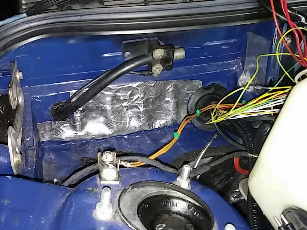

                              Decent clearance I think.

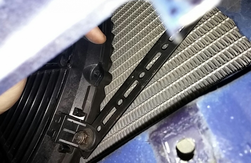

                              Showing the fan gasket. I need all the airflow I can get,
                              I trimmed the tray a bit.
                              Lots of room at the CAB.
                              I ground off a little for clearance.
                              The cam I used. They offer a more aggressive N31 grind but I don’t have the specs.

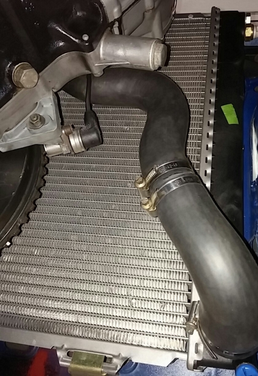

                              I had to Mod the hose a bit and used a coupling from Pegasus Racing.

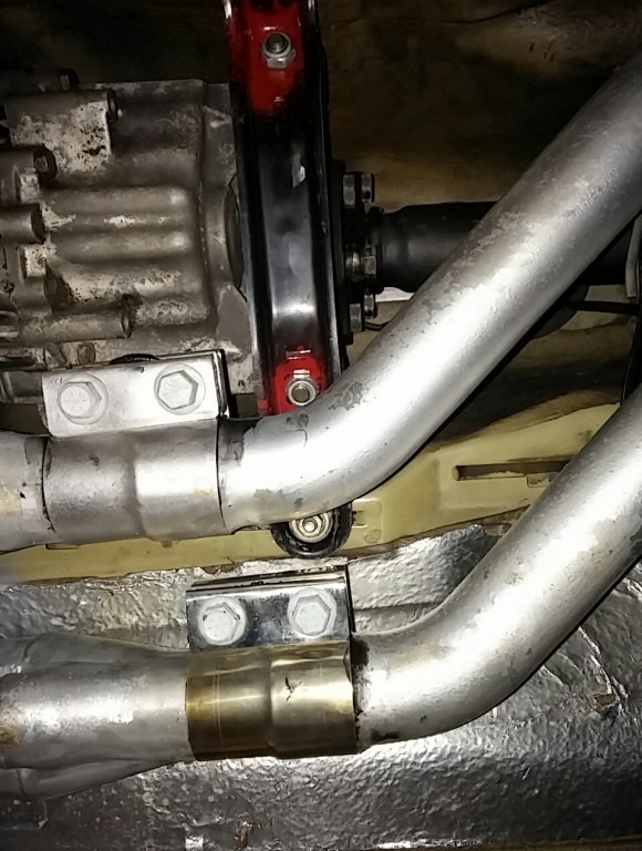

                              The Bavauto header collector goes all the way to the end of the 260/6.
                              Y pipe from Summit and resonator.
                              Big Guibo
                              That’s all for now…
